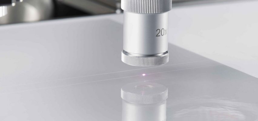

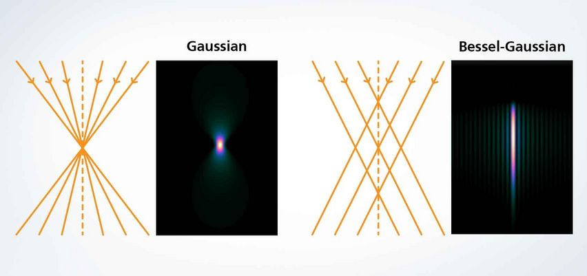

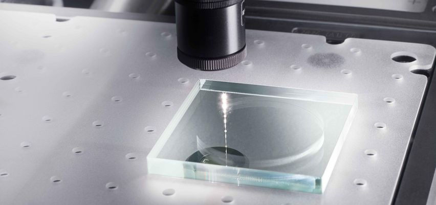

The TOP Cleave focusing optics distributes the intensity of the laser light along the beam axis. The focus is lengthened. The laser pulses modify the entire interior cutting surface of a pane up to 8 mm thick, depending on the pulse energy, in a single pass. With the high-performance lasers in the TruMicro Series 2000, 5000, and 6000 you can attain a cutting speed of more than 1000 mm/sec depending on the material and geometry.

Laser modification cutting allows ultra-thin glass (50 µm) to be cut with the highest edge quality. This significantly increases the rigidity.
Modification of glass
Extreme thicknesses greater than 8 mm can be efficiently processed and then cut with TRUMPF TruMicro lasers and TOP Cleave optics. After cutting, it is not necessary to post-process the cutting edge, such as by grinding or polishing.

With TOP Cleave focusing optics you can freely and precisely cut contours down to a hundredth of a millimeter. With extremely short laser pulses, you can modify a narrow area along any desired separating line. The change creates an intrinsic weakening, and the glass will break off in a controlled manner and with smooth edges.

Residue-free laser cutting of glass tubes with TOP Cleave optics. The glass tubes are processed with aberration-corrected, non-diffracting beams and ultrashort laser pulses. This allows glass tubes smaller than 15mm in diameter to have cycle times in the range of 0.1s per cut. Typical applications are in medical technology, with products such as ampoules, syringes and vials.

Glass tubes modified using aberration-corrected, non-diffracting beams can be used in combination with a selective etching process to produce even complex inner contours.
