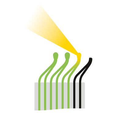

Hairpin

Hairpin-like windings instead of coil windings in an electrical motor: Hairpin-like windings made from rectangular copper wire inserted in a stator. The protruding ends are pressed together and laser welded with a scanner system. (Image: Gernot Walter)

As the industry seeks ways to accommodate volume production, companies are also starting to reconsider some of the traditional, yet sluggish, manufacturing methods currently used for electric motors. One example is the coil. Normally, the stators in electric motors are provided with a winding of copper wire. Each individual slot in the stator is wrapped in a winding that goes in and out, in and out, almost like knitting! That takes time – and it’s tough to automate.
The auto industry considers this process to have reached the limits of its productivity and is banking on a new technique known as hairpins. This involves using a compressed-air pistol to fire a rectangular copper wire similar to a hairpin straight into each slot. This method is several times faster – just one shot per slot – and it completely fills the space with copper, which increases the motor’s efficiency. The protruding parts of the hairpin on both sides are then pressed onto each other using a mask, or are jammed or twisted together.
The problem is that the hairpins are sometimes slightly out of alignment with each other after this process, with unsightly gaps in certain places. That’s when scanner welding comes back into play: a camera in the laser optics determines the orientation of the objects within the space and finds the ideal welding point within just a few fractions of a second. The beam focus oscillates and, in little more than a minute, all 200 of the welds required for each motor are finished – and the laser is ready to weld the connections for the next motor.

The second benefit of using high-precision scanner laser welding for hairpins is that it reduces the overhang of the weld seam to almost zero. The slots and hairpins can move closer together, and that means the motor takes up less space.
At this point the copper hairpins go under the laser for the second time, having already had their insulating enamel removed by a pulsed nanosecond laser earlier in the process, either directly on the coil or before winding. Mechanical methods to remove the enamel – such as planing and milling – can no longer keep pace with the required level of productivity.
