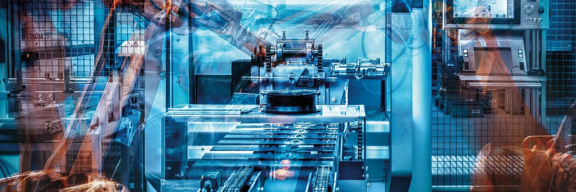

Intelligent production means: the machine finds out for itself what to do. (Picture: Detlef Göckeritz / Gernot Walter)
For this to work, the production needs highly flexible, easily controllable tools. (Picture: Jens Oswald / Gernot Walter)

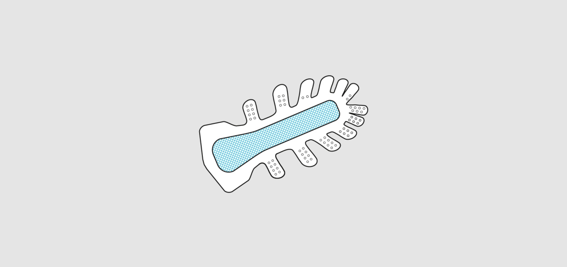

Additive manufacturing using powder bed fusion takes this process to its logical extreme. Loaded with metal powder, the machine simply waits for instructions and then produces whatever is required. The designers’ ideas are immediately brought to life. “3D printing is the pure embodiment of data-based manufacturing,” says Gebhardt. With such tremendous freedom to choose geometries, designers can create new and improved parts. That’s exactly what happened at Grindaix, a German manufacturer of coolant supply systems that was determined to improve its coolant nozzles using 3D printing. These nozzles are used to distribute lubricoolant on the part during ID cylindrical grinding. Now they are designed on the basis of bionic principles — and the benefits of this new approach are remarkable.
“We can create nozzles with curved channels designed for optimum flow,” says Dirk Friedrich, owner and CEO of Grindaix. “They deliver the right doses of coolant to exactly the right place on the part with lower pressure losses. Our customers benefit because they can run their grinding process faster and even achieve higher quality.” “We’re currently seeing a transition from the mass production of mass-produced parts to the mass production of individualized parts,” emphasizes Gebhardt.
Powder bed fusion turns an idea straight into an object like this bionic spine implant. Offering new levels of design freedom, it is the pure embodiment of data-based manufacturing. (Illustration: Gernot Walter)
