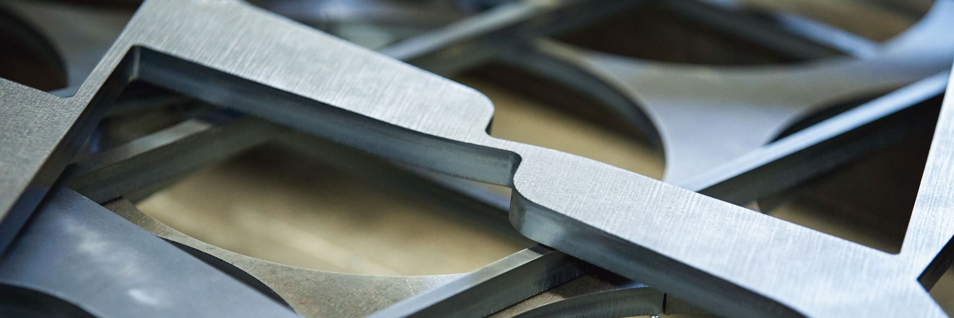

The BrightLine fiber option produces amazing cut edges at impressive speed, when working with mild steel 25 millimeters thick. (Picture: Claus Langer)
