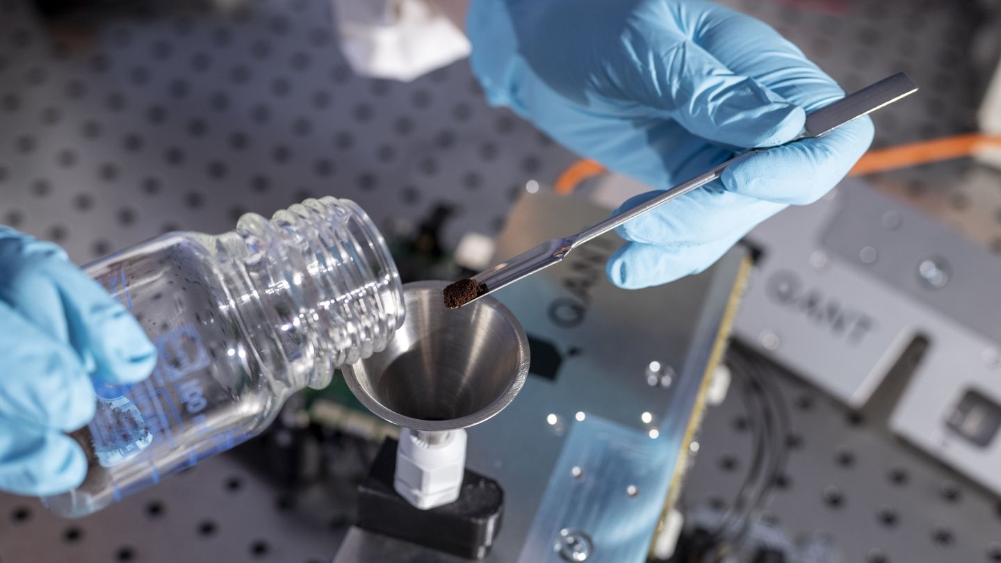

A Q.ANT specialist performs test measurements on coffee grounds. Liquids, gases and powders can all be measured by quantum sensors.
