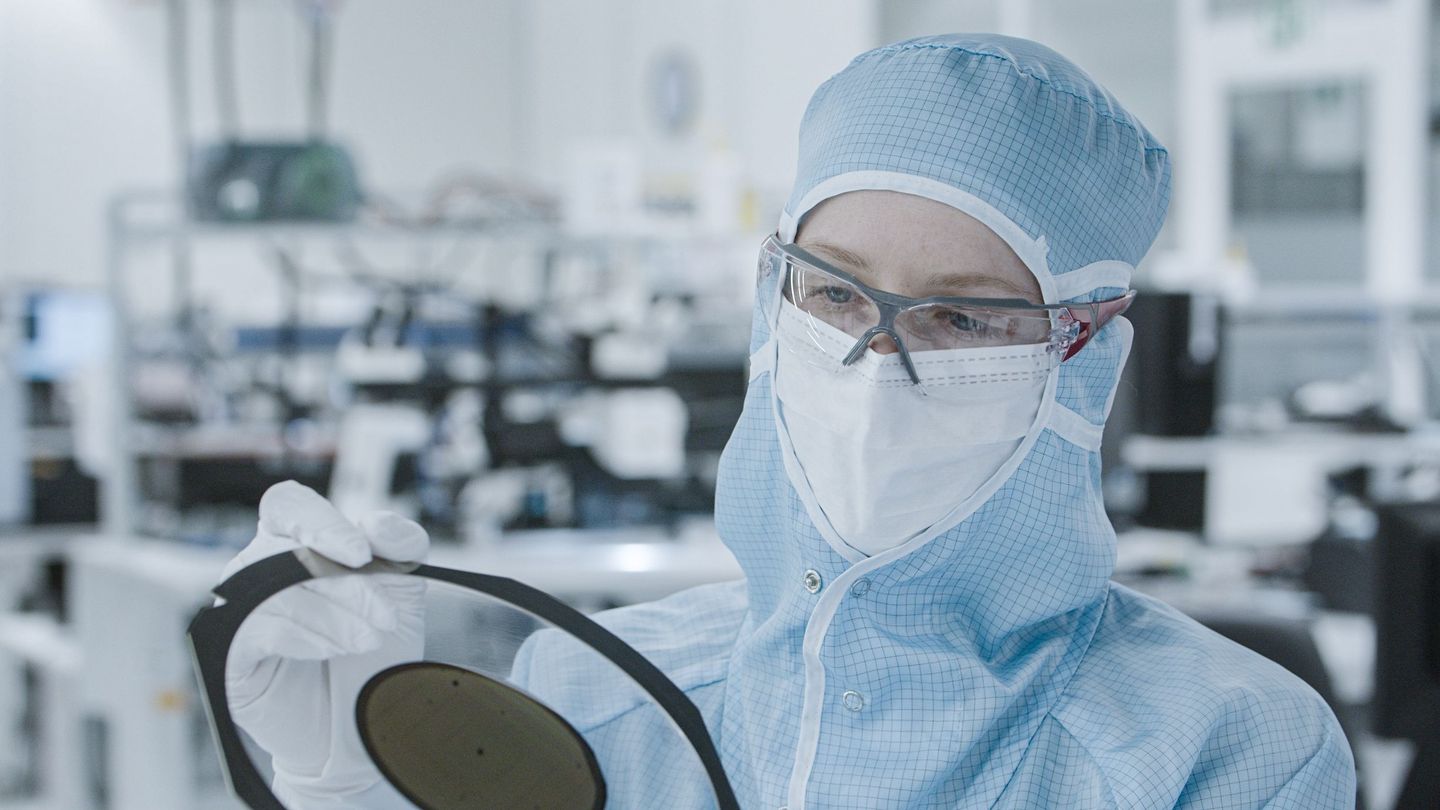

State-of-the-art clean room facility, TRUMPF Photonic Components
TRUMPF designs and manufacture its VCSEL solution at the state-of-the-art clean room facility in Ulm, Germany
