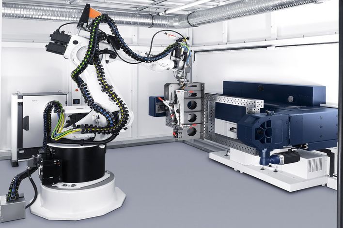

Custom marking is a natural part of what the machine does: Once quality assurance is complete, the robot in the FLEXCELL UNO type automated manufacturing cell transfers the workpiece to the fully integrated marking station.
Picture: TRUMPF
In this setup, the handling robot in the CHIRON FLEXCELL UNO first places the finished part into the measuring station, where the workpiece is measured. The robot then transfers the part to the marking station, where – providing the measuring data are perfect – the machine marks its product as a finished part, perhaps giving it a data matrix code that stores key manufacturing data or a reference number for the part such as a series or batch number.
