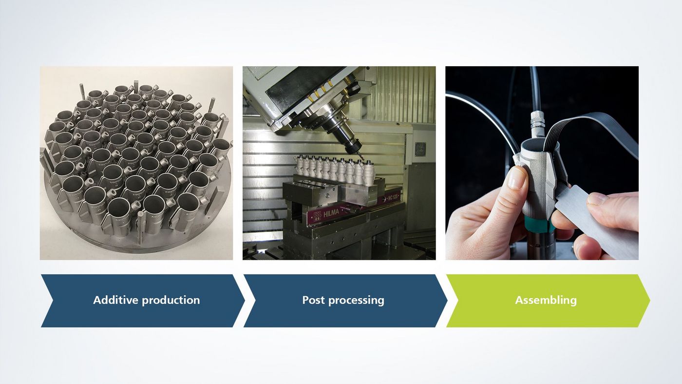

Customer example for additive manufacturing series production
Additive manufacturing has not only reduced production costs but also significantly simplified assembly.
Motor cooling element for TRUMPF cutting unit
  • 400 units per year produced from 316L stainless steel on a TruPrint 3000
  • Post-processing: Milling threads for inlets and outlets
  • 40% reduction in manufacturing costs compared to conventional production
  • Quality testing in series production on accompanying samples gives a relative density of 99.8% and a tensile strength of 700 MPa
  • Simplified assembly due to integrated flexure joint

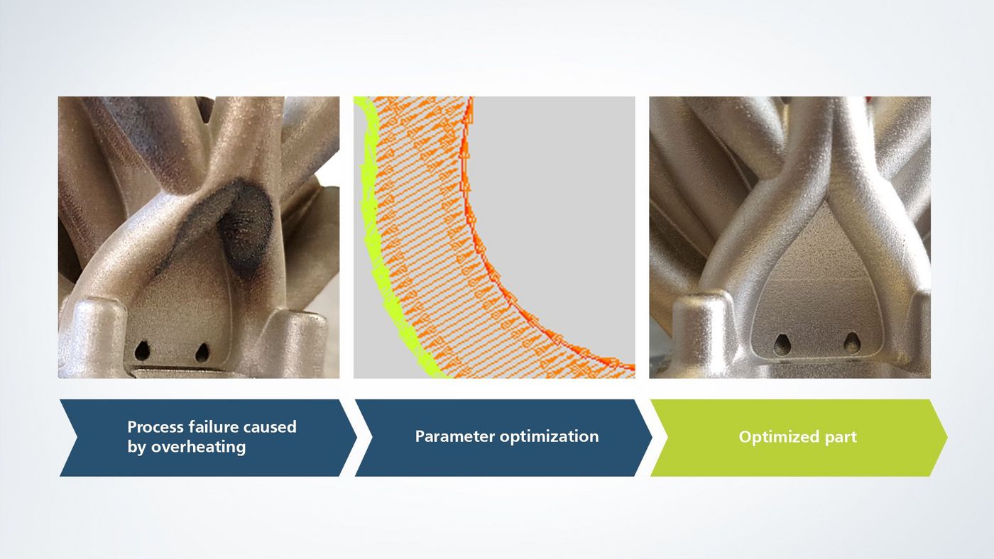

Customer example of process optimization
Overheating of the original component has resulted in poor surface quality and process defects. Parameter optimization and various test runs has resulted in an optimized, higher-quality component.
Benefits of process optimization
  • Improved surface quality
  • Improved overhang construction
  • Increased build rate
