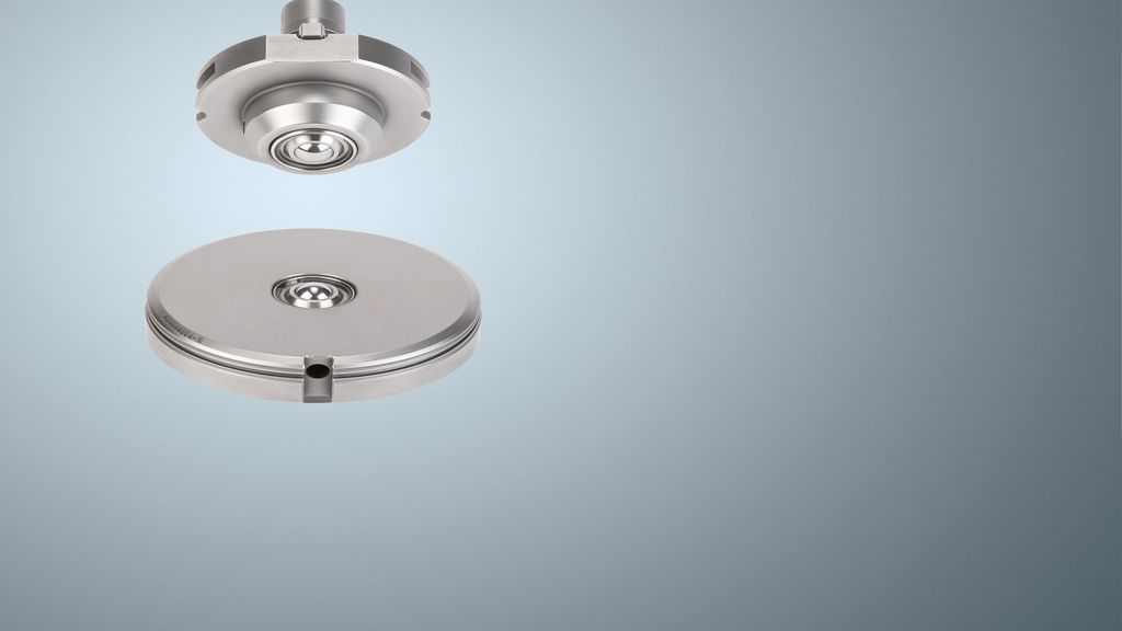

Deburr simple, large workpieces directly on the machine
Perfect edges
Ensure optimum edge quality by deburring simple, large workpieces directly on the machine.
Quicker production
Complete processing, performed on one machine, results in shorter production time.
Optimum deburring result
As a result of the perfectly rounded punched edges, you obtain parts that are virtually burr-free.
Maximum flexibility
Adapting the roller contour produces a high-quality result with all of the sheet thickness ranges.
The ability to produce burr-free sheet-metal parts directly on punching or punch laser machines saves you the time-consuming process of retrospectively removing the punching burr. This considerably reduces the throughput time, in particular for coated sheet metal and formed parts. Furthermore, the improved edge quality lowers the risk of injury when further processing the parts.
The roller deburring tool is mainly used for simple, large-surface contours. The punched edges are thus perfectly rounded off, which is a decisive advantage for visible edges in particular. A high-quality result is obtained with all of the sheet thickness ranges by adapting the roller contour to the modified burr and to the width of the separation gap.
