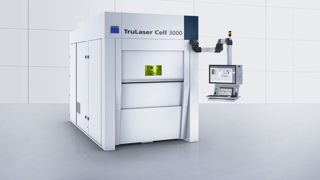

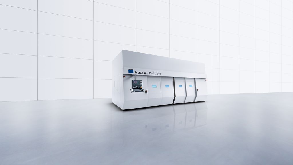

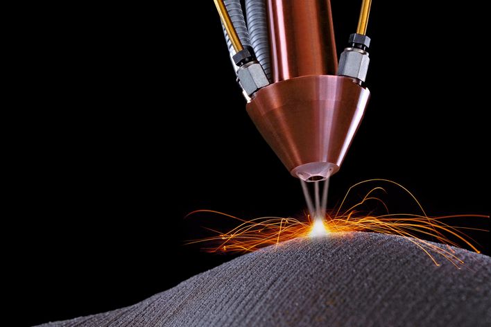

Automatic laser metal deposition
Automated laser deposition welding
In the case of automated deposition welding, the machine guides the filler material to the area to be welded. Although the material can also be a wire, this process primarily uses metal powders. Metal powder is applied in layers to a base material and fused to the base material and is fused to it without pores or cracks. The metal powder forms a high-tensile weld joint with the surface. After cooling, a metal layer develops that can be machined mechanically. A strength of this process is that it can be used to build up a number of similar or differing metal layers.
