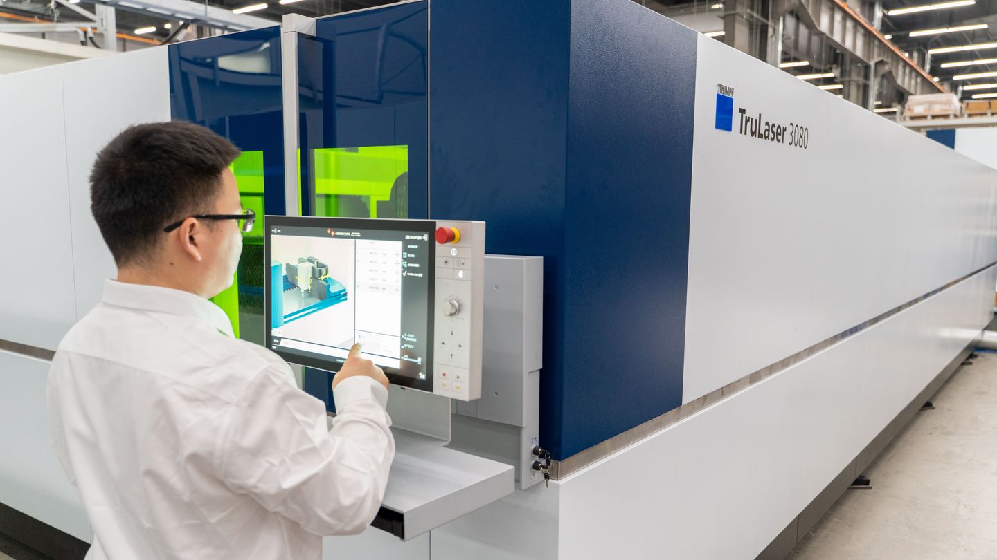

With the TruLaser 3080 fiber from TRUMPF, users can process even more orders in less time. (Source: TRUMPF)

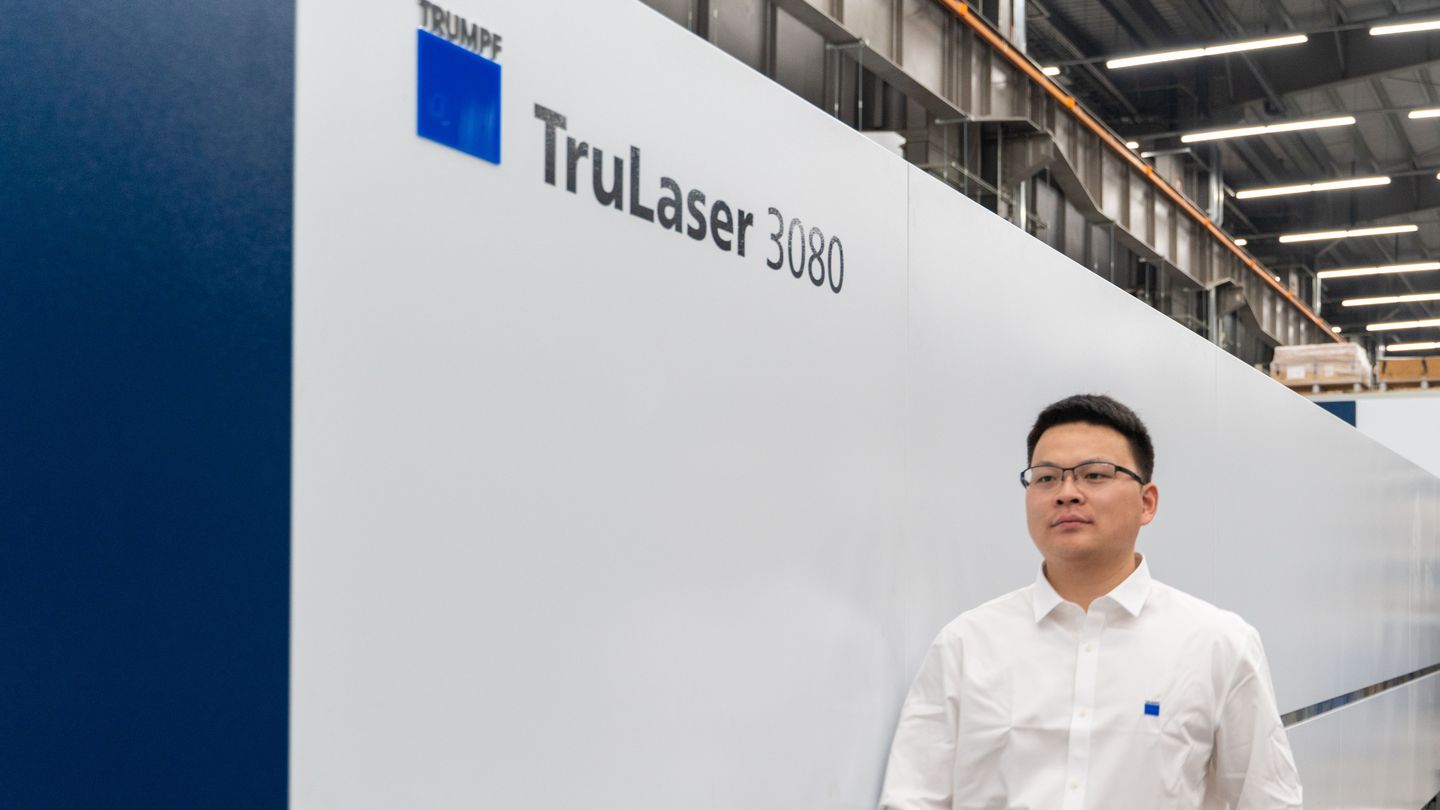

Processing oversize components
The TruLaser 3080 fiber from TRUMPF effortlessly cuts components out of sheets up to eight meters long. (Source: TRUMPF)
