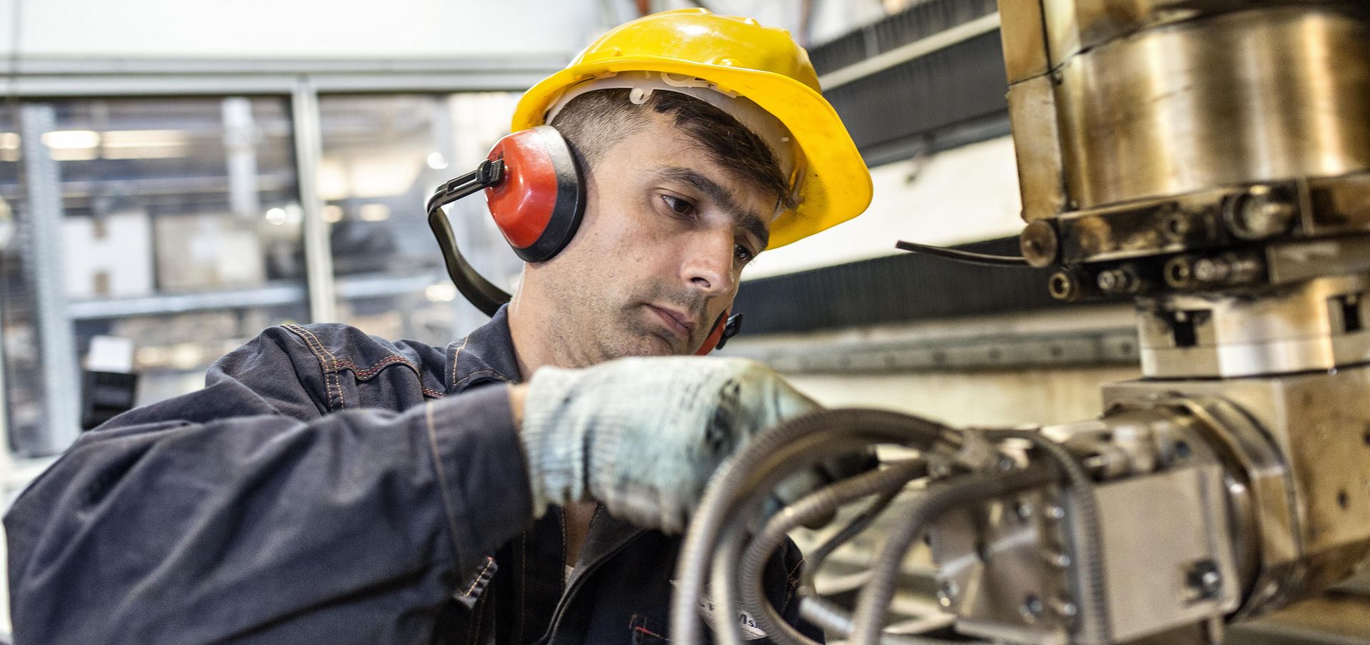

An employee prepares the Lasercell 1005.
ELFIM uses the Lasercell 1005 for various applications of laser technology such as 2D and 3D cutting or welding and also for laser metal deposition.
