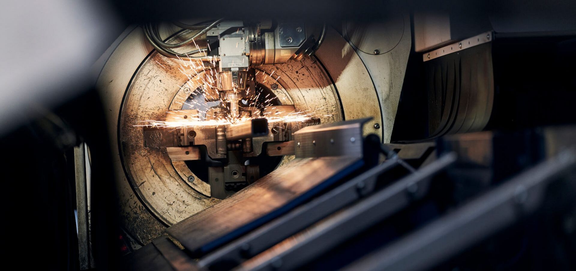

Blick ins Innere der Maschine beim Laserrohrschneiden
Features such as direct editing, the ability to simulate, and automatic programming of NC programs based on the 3D CAD design in Tube Design ensure that 99 percent of all parts run out of the machine as they should without operator intervention. (Picture: Stefan Hobmaier)
