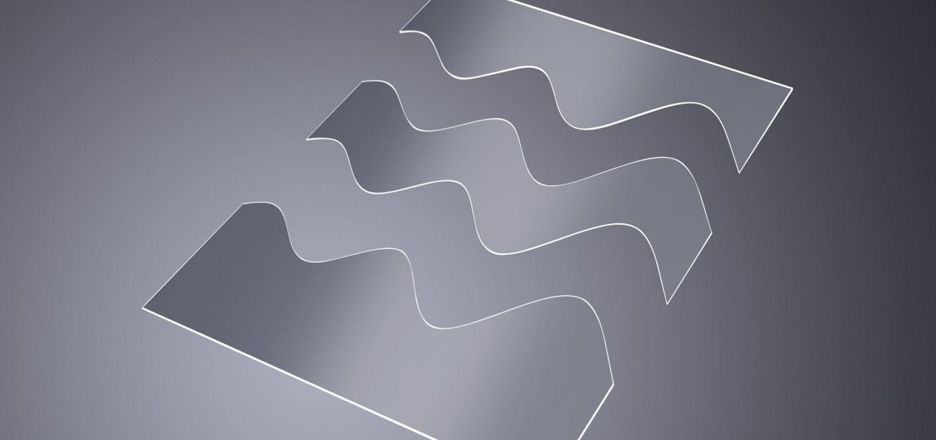

Ultra-short pulse lasers induce intrinsic tension in the glass. This results in a controlled fracture through the plane, along the stress line.
All outlines are possible: no matter whether straight or curved. Inside curves are no problem, either.

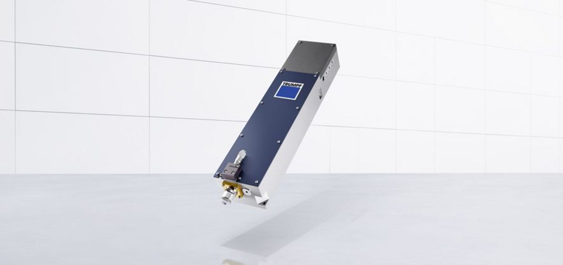

The new flagship among the TruMicro lasers is the TruMicro 5080. It delivers, at up to 1,000 kilohertz, the highest repetition rate and with a maximum of 500 microjoules the highest-energy pulse in the world of ultra-short pulse lasers for industrial use. The laser produces average power exceeding 150 watts – making it extremely powerful in every application.
The TOP Cleave optics can distribute the high power of the TruMicro 5080 along such a long focus line that the laser light can use modification techniques to separate glass more than one millimeter thick. The TruMicro 5080 is also available in the femto edition. It is the first industrial laser that can produce femtosecond pulses in the green spectrum.

TruMicro 5080
The new flagship among the TruMicro lasers. With average power of 150 watts, repetition rate of up to 1,000 kilohertz and maximum pulse energy of 500 microjoules, this is at present the most powerful ultra-short pulse laser for industrial use.
Green light can be focused down to a very small spot. Green radiation has a larger Rayleigh length than infrared light and, as a consequence, greater depth of focus. This makes the TruMicro 5080 especially well suited for drilling extremely fine and precise holes such as those found in injection nozzles.
A further advantage of the TruMicro 5080 is that it can easily be integrated into industrial machinery and can be maintained while still inside the equipment. This eliminates troublesome removal and the subsequent readjustment of the beam path. A new technical concept is responsible for this.
All the relevant components for maintenance and exchange – like power cables, cooling lines, the electronics and the optical area – are easily accessible from a single side. This lowers the downtime for machine tools and boosts their economy considerably.
