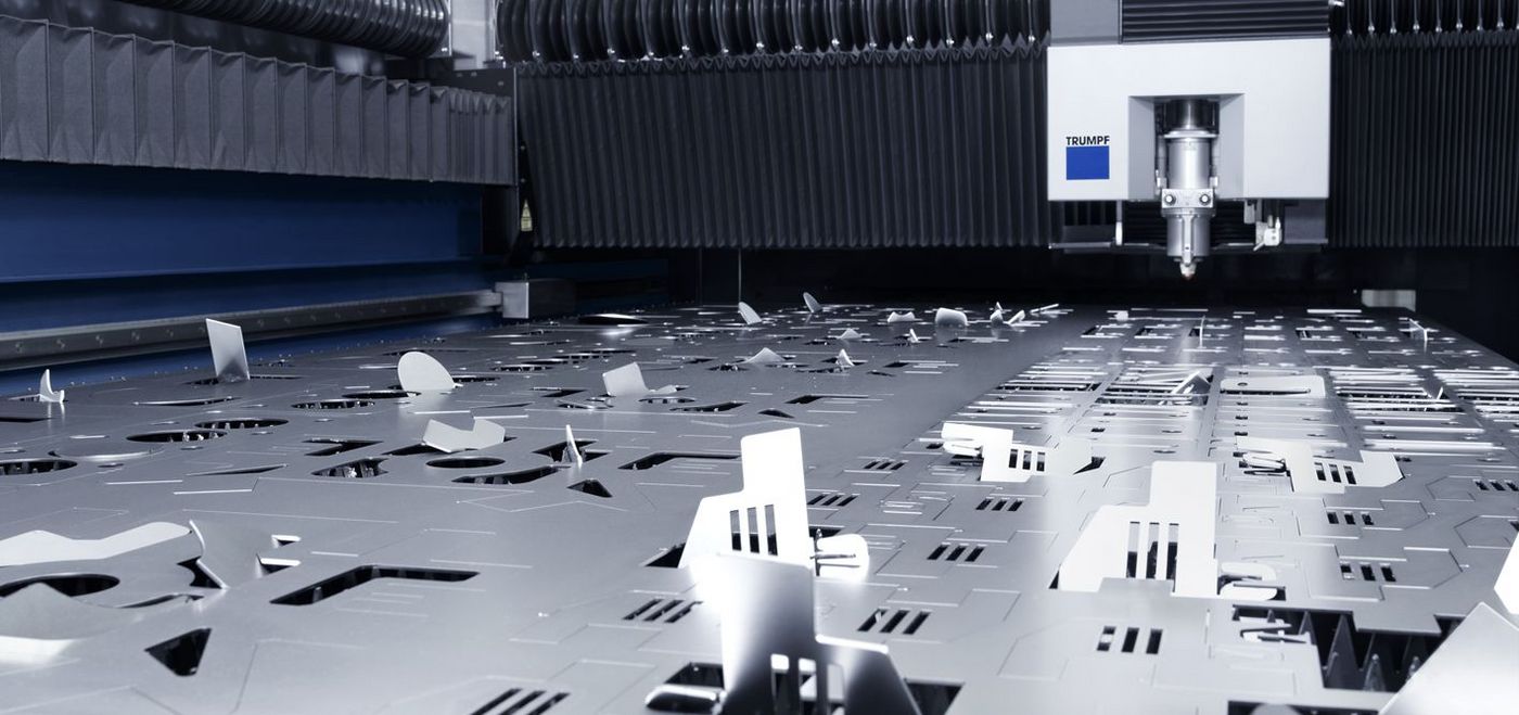

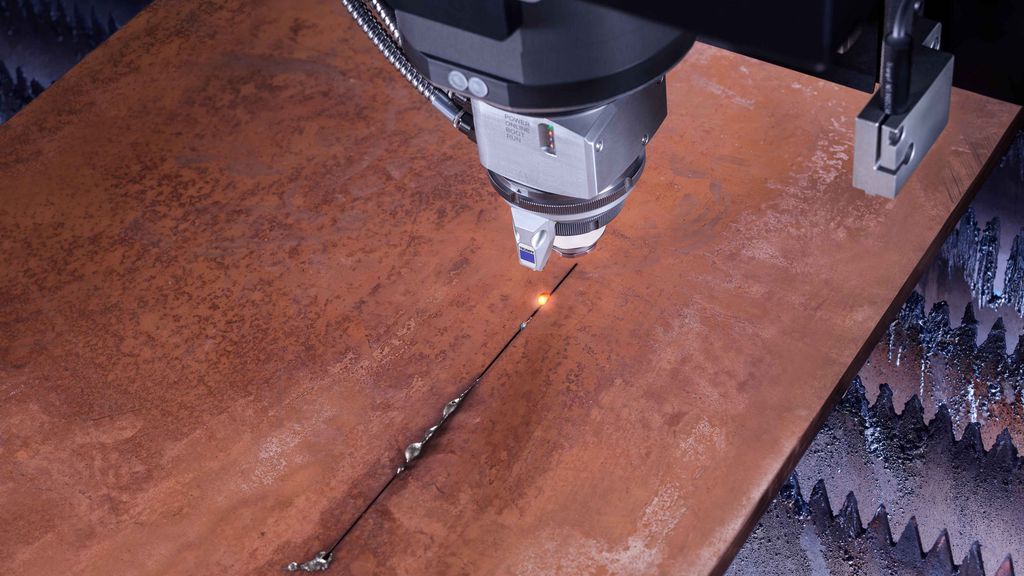

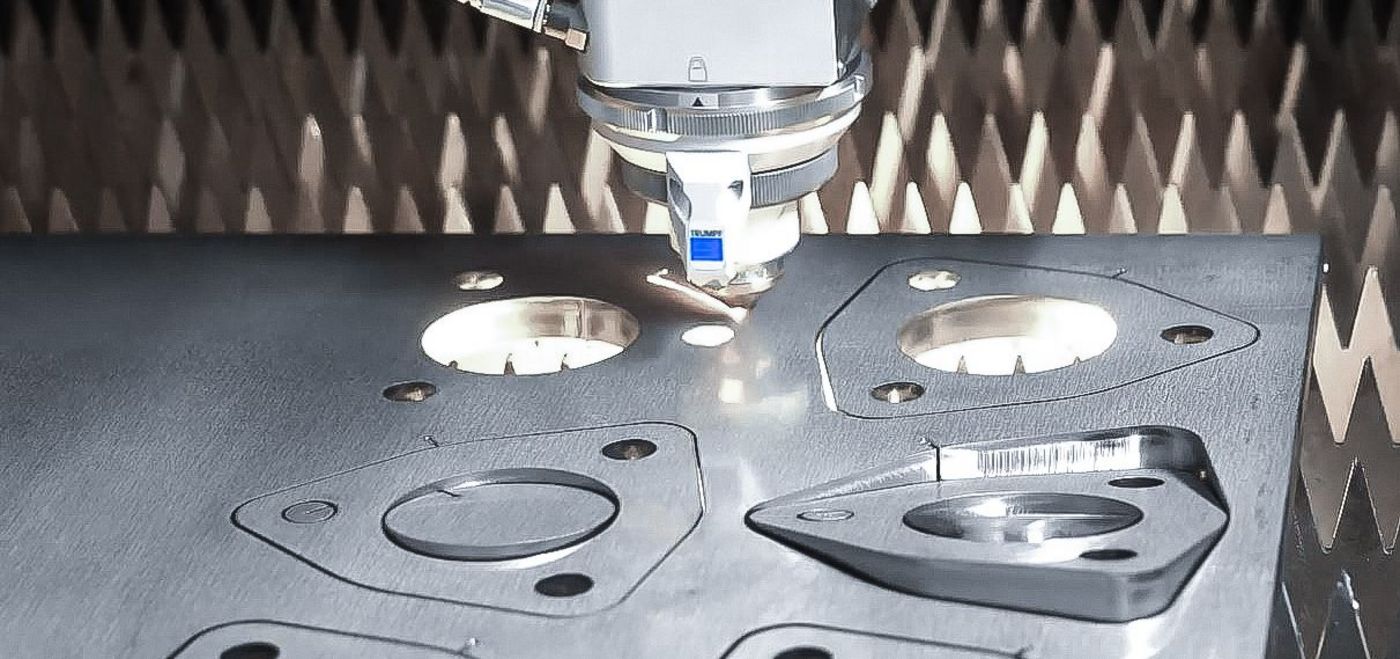

The cutting process is monitored in real time from above with a view through the cutting nozzle. The sensor system monitors the cutting gap, determines the optimum feed rate and adjusts it as required - several hundred times per second. This minimizes cutting interruptions due to material differences such as variations in sheet thickness, rust or paint contamination. In the event of an impending cutting flaw, Active Speed Control ensures that the machine stops. In conjunction with Smart Rerun, a restart can take place automatically or you can switch to the next part. Active Speed Control also reduces burr and slag formation. The minimized reject rate leads to lower parts costs.

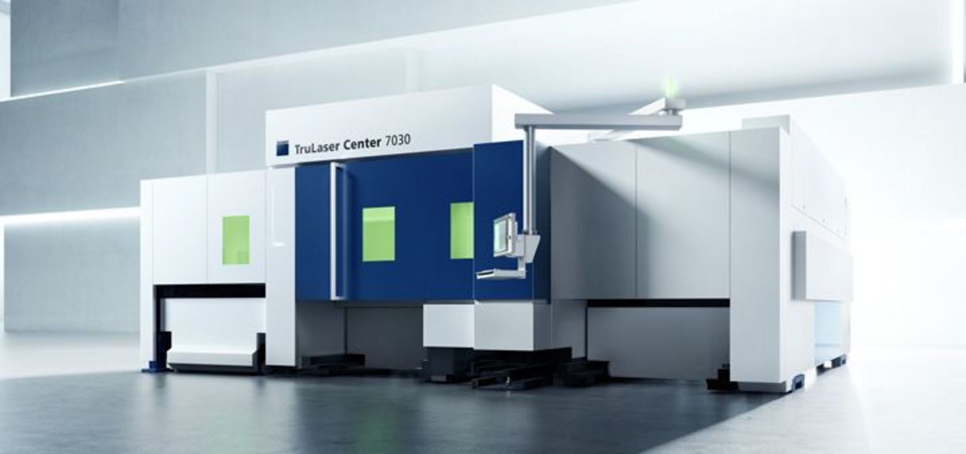

Our vision is clearly defined. We have our sights set on developing machines which operate autonomously. With the Active Speed Control system for adaptive feed control and the TruLaser Center 7030 full-service laser machine, we have crossed the threshold to the third stage on the scale. The fifth stage is a fully autonomous machine. When it comes to classification, the following parameters are especially taken into account for location determination: proportion of manual monitoring and operator involvement at the machine. The focus lies on a machine's ability to recognize, prevent, and resolve malfunctions independently – without human intervention. Our vision is for the operator to have a central role involving having control and managing the process.

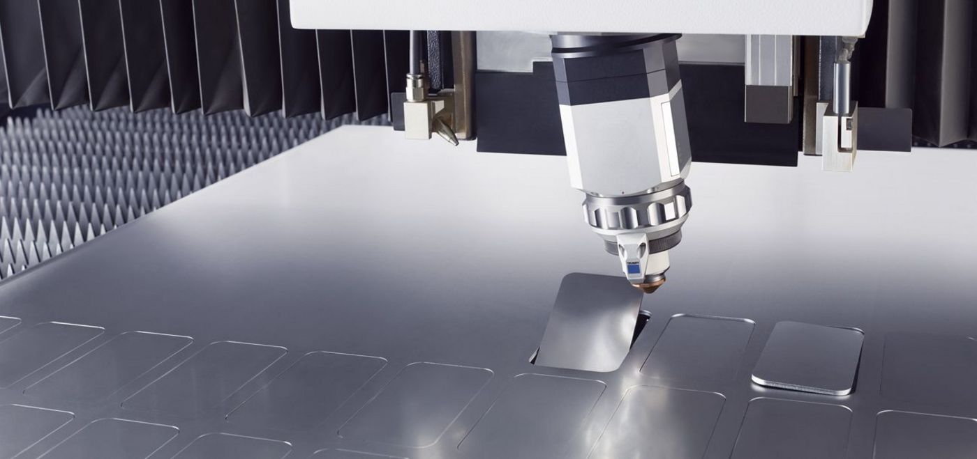

Part of our vision of fully autonomous laser cutting is already a reality. Intelligent assistance systems for laser cutting develop execution strategies, for example, which prevent collision with tilting parts, or make post-producing of parts out of remainder sheet easier. Even nozzles are automatically inspected and replaced if necessary. The proportion of machine functions which control processes independently is ever-increasing.

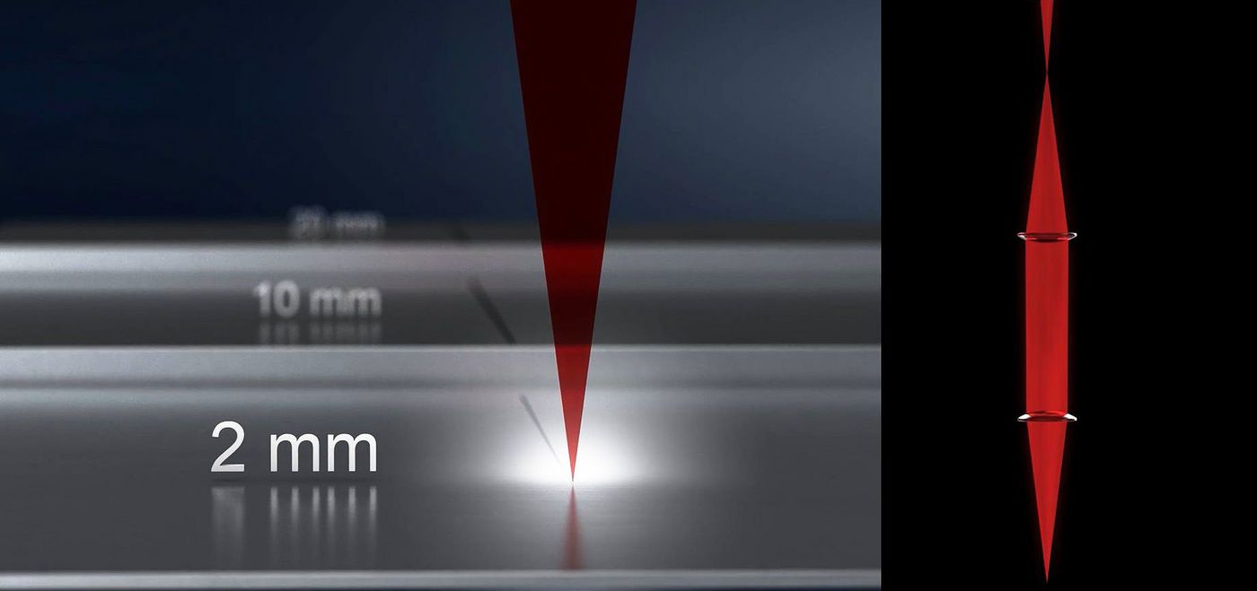

An important milestone on the path to autonomous machines is the Active Speed Control system for adaptive feed control. The system monitors the kerf through the nozzle, oversees the cutting process, and independently regulates feed speed. It ensures the right feed level for flame and fusion cutting, even in the event of thickness variations in a sheet, or if the sheet has been affected by quality fluctuations (i.e. rust or coating remnants). Data analysis makes quick and stable cutting possible. This can prevent disruptions to cutting, and noticeably reduces the number of reject parts. The operator is also relieved. They can pull up the most important process parameters or a live-image through the nozzle any time, and will be actively informed if the need for intervention arises. Tapeshots which were necessary up to this point are now a thing of the past.
Active Speed Control oversees the process, controls cutting

Leading the way – TruLaser Center 7030
