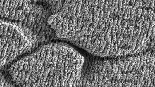

Close-up of the surface structure of blackmarking
Black marking
Due to extremely short laser pulses, you can create durable and deep-black markings without damaging the material surface through ablation. The perfect procedure for creating corrosion-resistant markings, for example in the medical technology sector.
