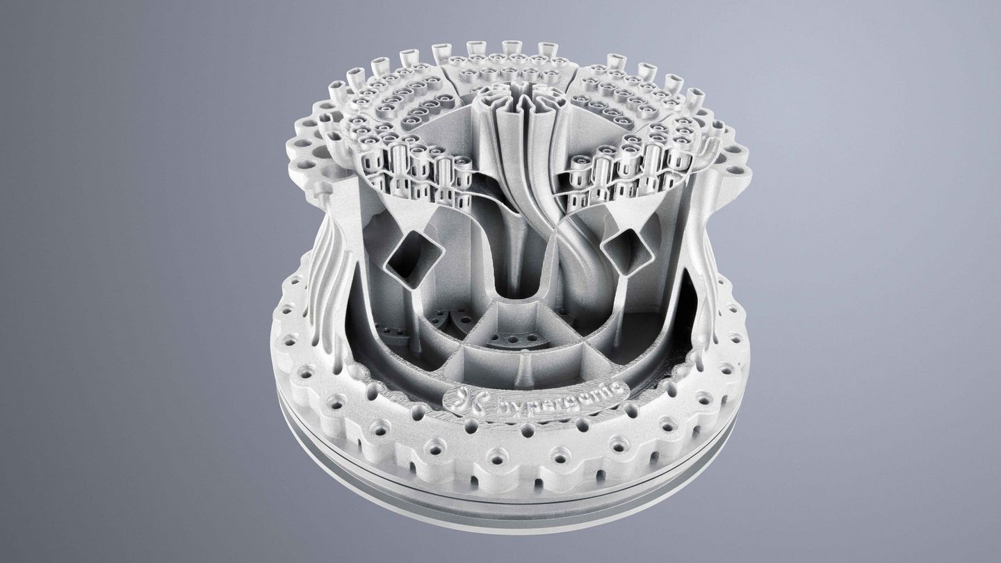

Hyperganic injector head
Aviation and aerospace TruPrint Titanium Additive manufacturing

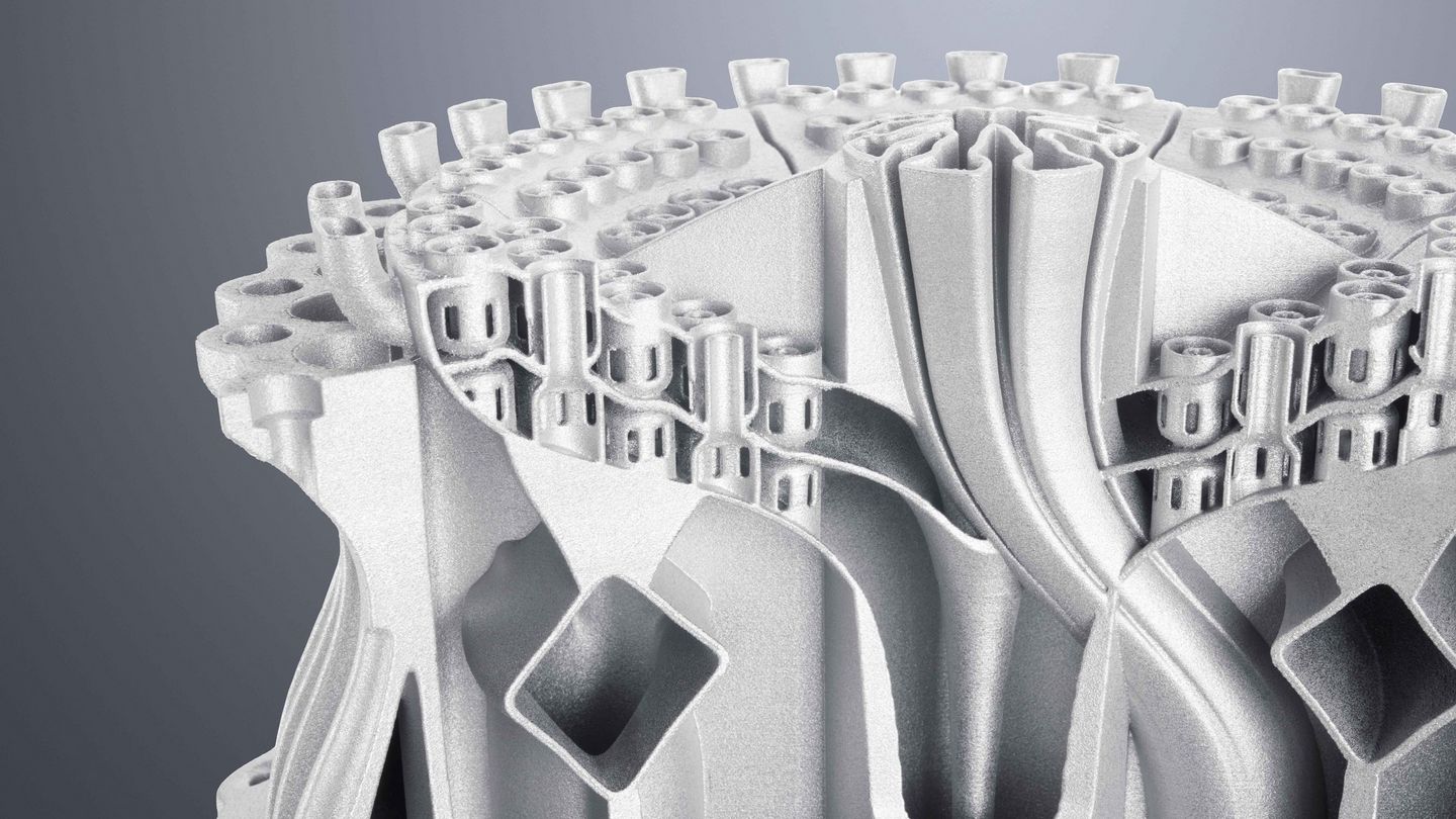

Algorithmically developed injector head, additively manufactured from a super high-performance titanium alloy. The range of parts that can be manufactured with LMF has been expanded thanks to the 932°F preheating option. The residual stress to which the parts are subjected has been significantly reduced while productivity has improved. Ti-6242 offers impressive mechanical strength and stability in addition to strong resistance to corrosion and creepage at temperatures up to 1112°F.
Cost reduction
Reduction of residual tension
Design freedom with additive manufacturing
Easy powder removal vs. E-PBF

Facts & figures about the example part
Material: Ti-6Al-2Sn-4Zr-2Mo-0,08Si
Dimensions: ⌀ 285 x 145 mm
Construction duration: 27.8 h
Number of layers: 2.410, ea. 60 µm

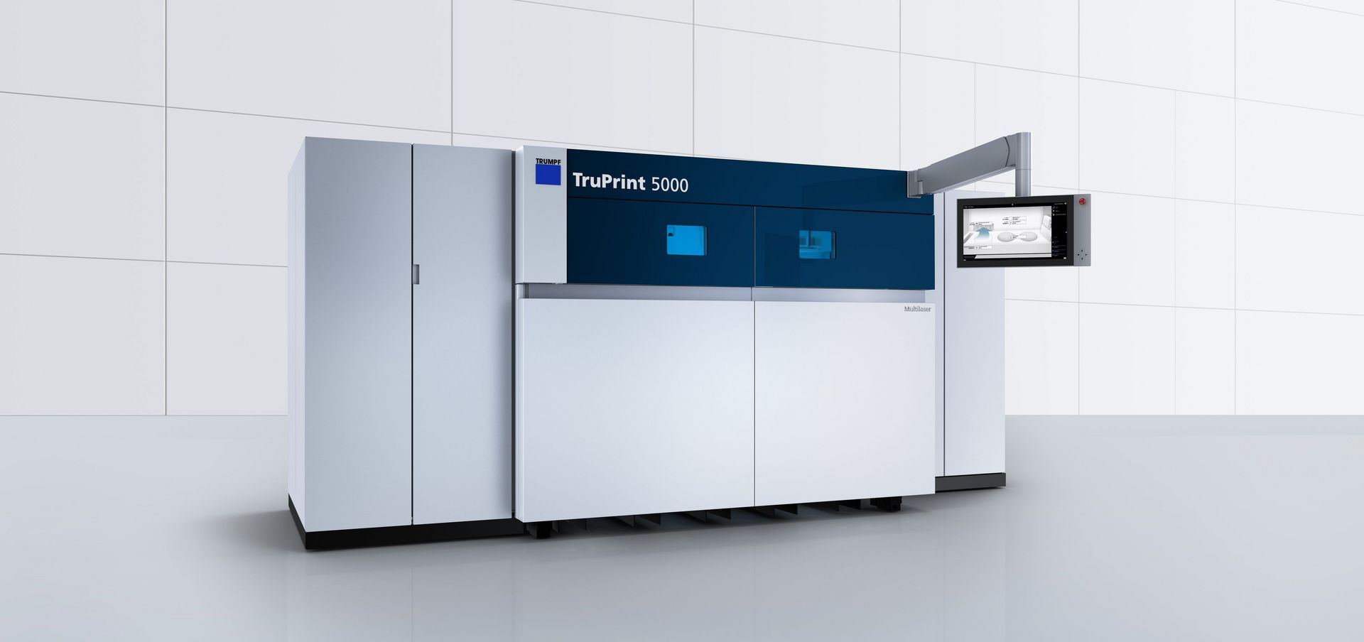

TruPrint 5000
TruPrint 5000
The highly productive, semi-automated 3D printing system TruPrint 5000 prepares you for industrial batch production –  with features such as optional 500 °C preheating and the full-field multilaser equipment with three 500 watt TRUMPF lasers.  Thanks to the preform option, the TruPrint 5000 supports hybrid component production. For this purpose, the component structures to be additively manufactured are applied to a blank.
