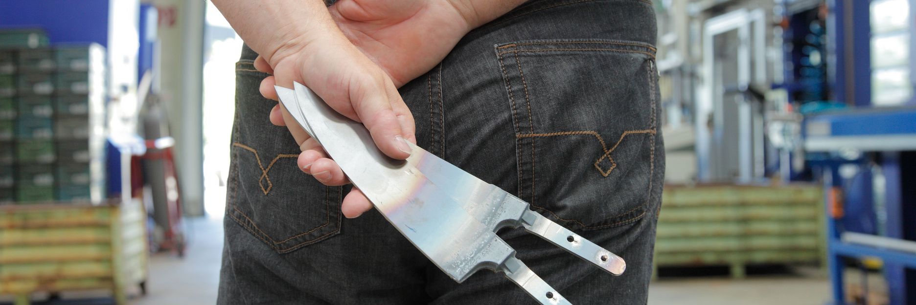

Down comes the forging hammer on the bead in the center of the blank to form the bolster, located between the blade and the tang. This will later serve to protect the hand. The force of the blow drives the steel out in all directions and destroys all reference points for the workpiece’s edges. This rules out laser for cutting the contours of the knife. After all, without reliable edges, there can be no reliable positioning.
Yet laser cutting was so tempting. The contours could be user-programmed, the process wouldn’t need any tools, and the mechanical stress on the steel would be zero.
A single reference point
Tempting as it was, however, it just wouldn’t work. Not in the process that knife manufacturer Zwilling was using. Ulrich Nieweg, head of Zwilling’s prefabrication department, explains: “Fifteen years ago, we introduced upset forging so that we could form the blade, bolster, and tang — the piece in the handle — from a single blank.”
The piece of blade steel is heated and compressed, and the resulting bead that forms in the middle is then forged by a screw press to create the finished bolster. With its defined shape, the bolster is the only constant reference point. “During subsequent contour cutting, the die would hold the bolster and use it to determine the position of the workpiece in the tool. All other dimensions were secondary for us,” says Nieweg.
