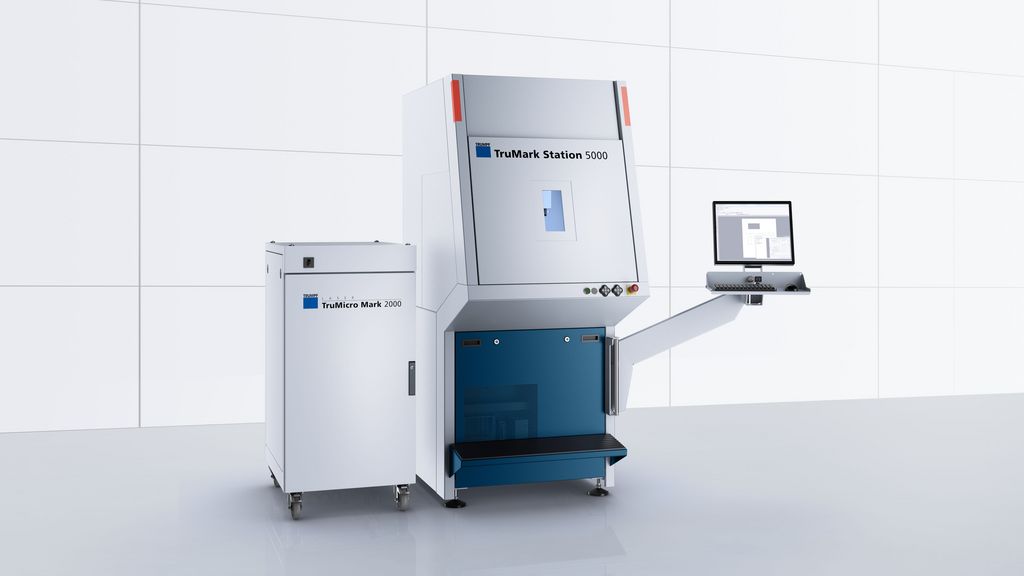

The laser - that much became clear very quickly - is the tool that can optimally meet Miethke's many challenges. Black marking proved to be ideal as a concrete procedure. This is due to the fact that the extreme peak pulse power changes only the surface structure, and there is no material ablation. As processing is contact-free with only a small heat-affected zone, the component does not change its shape and its metallic structure remains virtually unchanged. This retains the biocompatibility of the titanium. Black marking creates deep-black, high-contrast markings on Miethke valves, such as the implant's direction in the form of an arrow, which remains legible even under highly reflective surgery lamps. Miethke utilizes the ultrashort pulses of the TRUMPF marking lasers not just for marking, but also for laser precision cutting of the valve's microtechnology components. The company has found the ideal solution for both production tasks in the TruMicro Mark.

Learn more about the specialists for medical technology! With our turnkey complete solution, the TruMicro Mark 2000, you can create deep-black, corrosion-free laser markings (black marking) with ultrashort pulses.

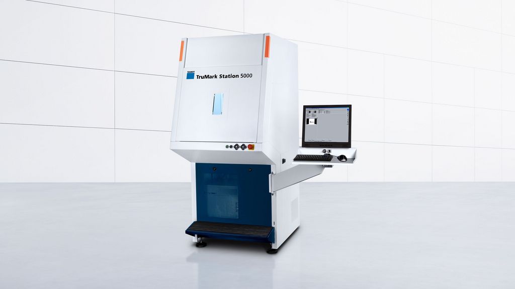

TruMark Station 5000 – flexible all-around solution for convenient marking
This laser marking system is a genuine allround talent. Due to its ergonomic design, the station can be used for medium and large lot sizes as both a standing or seated workstation.
