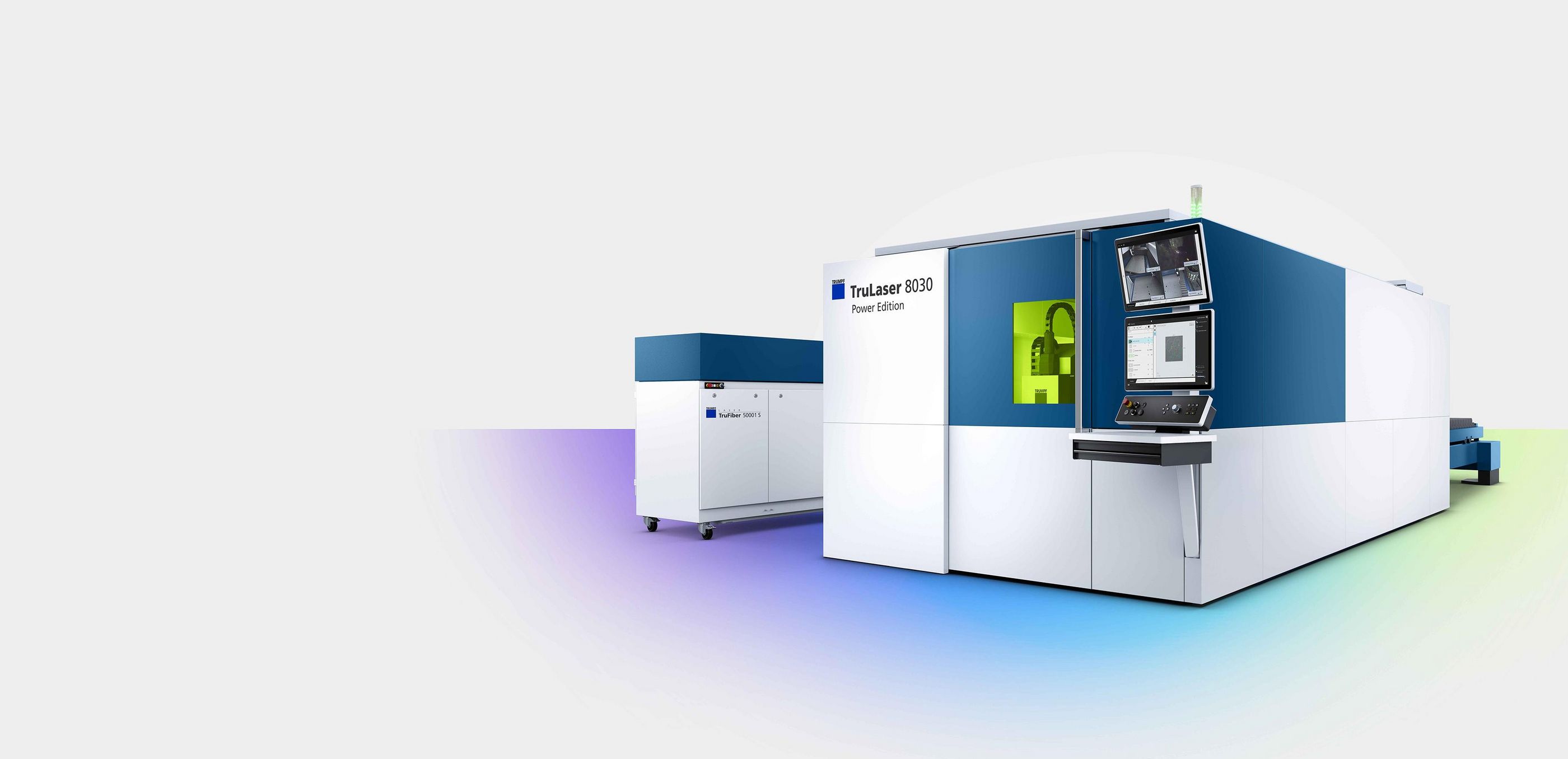

The TruLaser Series 8000 Power Edition sets new standards in high-performance laser cutting. With 50 kW of laser power, high machine dynamics, and an exceptionally robust design, you can cut faster, process thicker materials, and achieve top-notch part quality – even under the most demanding production conditions.
50 kW for maximum cutting speed
Up to 200% faster cutting speeds and expanded range of sheet thicknesses for new applications.

Dimensions
Length 9750 mm 11700 mm 15450 mm 19620 mm
Width 6145 mm 6373 mm 6878 mm 6968 mm
Height 2200 mm 2200 mm 2200 mm 2200 mm
Maximum speed
Simultaneous 283 m/min 283 m/min 170 m/min 170 m/min
Working range
X axis 3000 mm 4000 mm 6000 mm 8000 mm
Y axis 1500 mm 2000 mm 2500 mm 2500 mm
Maximum workpiece weight with heavy-duty pallet changer 2900 kg 5150 kg 9600 kg 12800 kg
Maximum workpiece weight on both pallets with heavy-duty pallet changer 3625 kg 6435 kg 12000 kg 16000 kg
Laser-specific data - TruFiber 50001
Maximum laser power 50000 W 50000 W 50000 W 50000 W
Max. Blechdicke Baustahl 60 mm 60 mm 60 mm 60 mm
Maximum mild steel sheet thickness with cutting package for thick sheets 80 mm 80 mm 80 mm 80 mm
Max. Blechdicke Edelstahl 60 mm 60 mm 60 mm 60 mm
Maximum stainless steel sheet thickness with cutting package for thick sheets 80 mm 80 mm 80 mm 80 mm
Max. Blechdicke Aluminium 60 mm 60 mm 60 mm 60 mm
Maximum aluminum sheet thickness with cutting package for thick sheets 80 mm 80 mm 80 mm 80 mm
Consumption values
Average power input in production - TruFiber 50001 45 kW 45 kW 45 kW 45 kW
