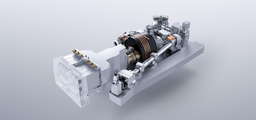

High-performance solid-state laser
The TruDisk is a high-power solid-state laser for the welding, cutting, and surface processing of metals. It impresses above all in situations which require the combination of high power and maximum beam quality. The new generation of TruDisk lasers provides you with great advantages, above all due to its much more compact footprint and increased robustness. It also has intelligent inner parts. The data quality of the sensor systems which monitor all the important parameters in the laser has been improved significantly so that the new TruDisk lasers are perfectly prepared for future Industry 4.0 services such as condition monitoring. The TruDisk operates economically in all laser states due to increased efficiency, a new pulse function with increased energy efficiency, and intelligent energy management.
Stable processes through integrated, active laser power control ensure reproducible results.
As a laser medium, the disk in the TruDisk ensures brilliant beam quality up to 2 mm·mrad.
The patented resonator design means that your TruDisk can also process highly reflective materials.
Multiple energy-saving modes and the power factor correction reduce the power requirement.
With BrightLine Weld you can achieve high-quality welding seams with minimal spatter formation.
Choose between an integrated heat exchanger (standard) and compressor cooler (optional).

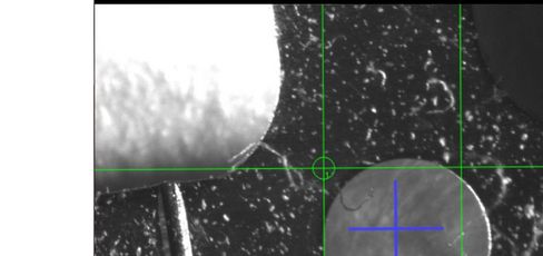

Image processing
TRUMPF VisionLine image processing detects features on the components and ensures that welding is always in the correct location.

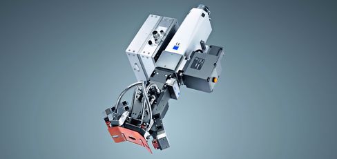

TRUMPF offers you all the components you need for beam guidance from the laser to the workpiece. This also applies for various focusing optics which have proven themselves to be precise and reliable over many years of industrial use. The optics can be easily integrated – both in stand-alone processing stations as well as in complete production lines. The modular structure enables the optics to be continually adapted to the laser types as well as the different processing situations.
Focusing optics

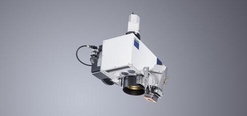

Regardless of whether you are welding, cutting, ablating, heat treating, or drilling, you can count on high-quality process results with robust focusing optics from TRUMPF.
Programmable focusing optics
The ideal optics for remote processing
