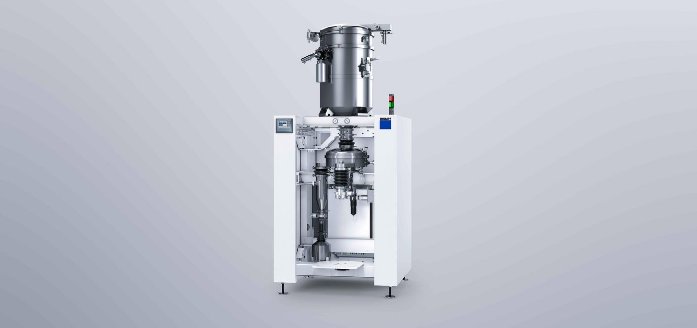

External powder removal
Select from two variants to remove powder from the component: remove powder from your part with the depowdering station (with the option of using shielding gas) for a very high degree of purification. Vibration technology also removes powder from complex component geometries. Alternatively, you can also remove powder from the part externally in the depowdering station while avoiding contact with the powder. Use the components of the industrial part and powder management system for several 3D printers and reduce your part costs.
