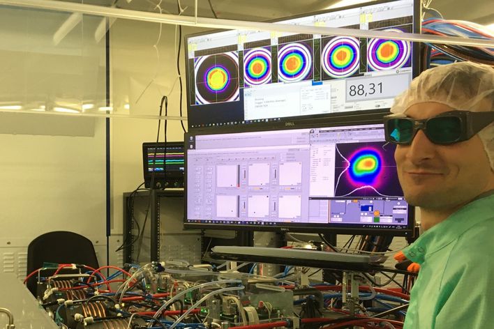

Here in Bochum and elsewhere, 200 scientists are working in one huge research cluster to understand the influence of solvents on biochemical processes. My group’s job is to build more powerful terahertz sources which the other researchers can then use for measuring purposes. Our primary goal is to create a tool for observing the dynamics of molecules, in other words the changes from one state to another over time. Put simply, we want to make biochemical videos. The best tool for doing that is one that uses pulsed terahertz waves. Specifically, very short ones with exactly the right frequency and high-power values. To do this, we feed our system with a near-infrared femtosecond laser. We fire the pulses through a non-linear crystal that converts them into terahertz pulses. Perform a few more electro-optical tricks–technically referred to as terahertz time-domain spectroscopy–and you can use those pulses to measure things. Our pulses are special because we have demonstrated for the first time that it is actually possible to achieve relatively high-power values of dozens of milliwatts. And we haven’t finished yet–now we’re aiming to get that up to the watt level.

We were the first to use a high average power laser in time-domain spectroscopy. Nobody dared to do that before because it’s so hard to control a system with so much power. We built our own laser using TRUMPF components with more than 100 watts of average power and operating with a very high repetition rate of 13 megahertz. The terahertz pulses it produces will help researchers gain fundamentally new insights.
