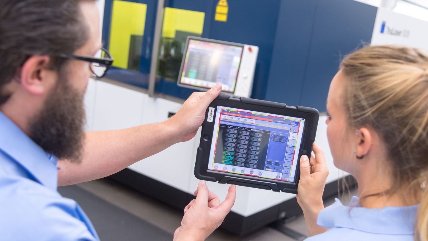

Complete laser processes - from the power socket to the process zone - can now be mapped in the form of data and then monitored and controlled. That's why the optics, sensors and beam sources TRUMPF is presenting at this year's LASYS are the perfect choice of tool to integrate in the digital world of the smart factory. The data they generate can be made available to many of the applications that are becoming standard in Industry 4.0, such as quality data storage and cockpits for data visualization. With remote access to the laser via a secure IT system, customers can also choose to benefit from the expertise and experience TRUMPF technicians have accumulated for a range of applications by taking advantage of services such as condition-based monitoring and predictive maintenance. The data is transmitted through encrypted channels to a cloud, where a combination of algorithms and real TRUMPF experts evaluate it to produce trend analyses. That paves the way for predicting anomalies and their effects in the machining process, leading to major improvements in machine availability.

Condition Based Monitoring
Condition-based monitoring allows the operator to monitor and control a machine and its operations using a tablet – from anywhere, at any time.
