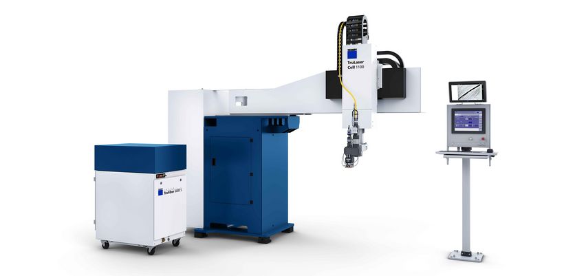

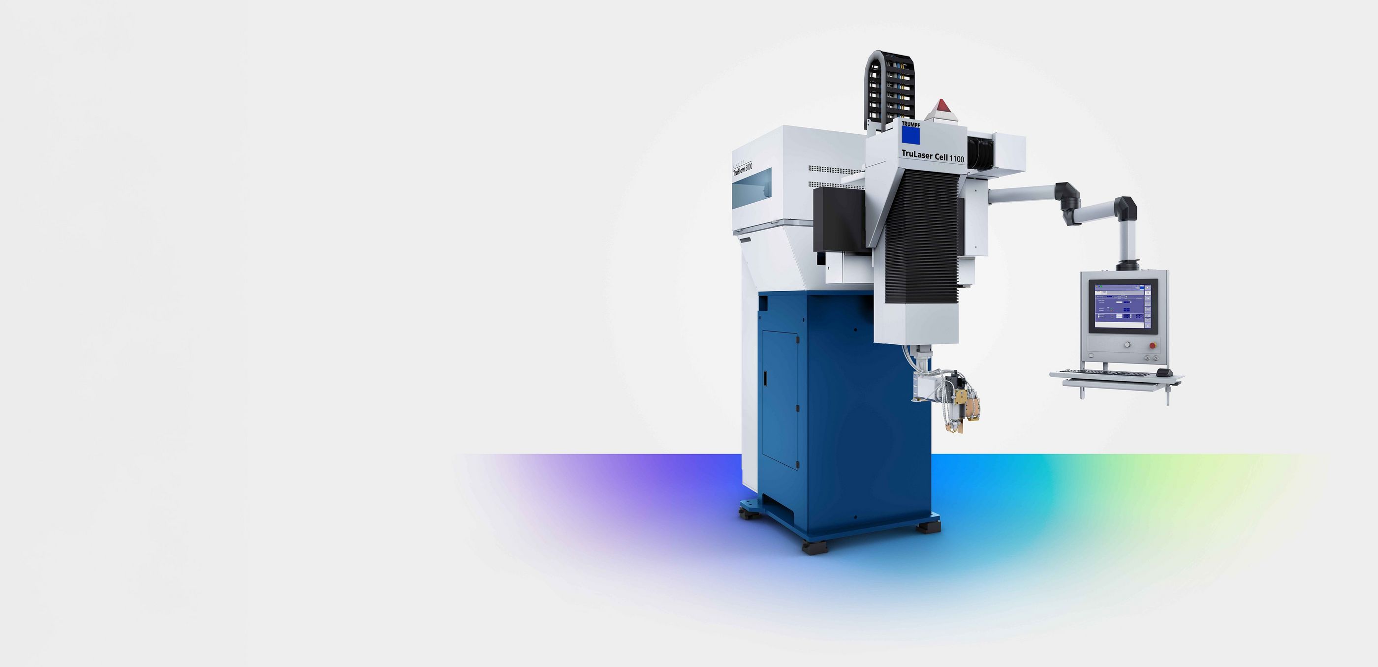

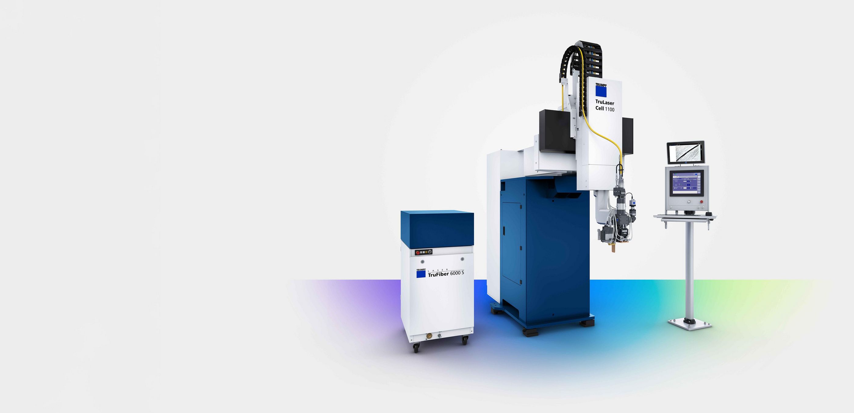

The TruLaser Cell 1100 is a flexible beam guidance system that you can integrate easily into your production line. It is specially designed for the endless welding of any seam geometry on strips, tubes, and profiles. You have a lot of freedom when it comes to the material. With the laser welding system you can weld steel, stainless steel, aluminum, and even non-ferrous metals, from a tenth of a millimeter up to several millimeters thick. Sensor systems for seam detection and tracking (e.g. SeamLine) increase flexibility, quality, and reliability. Depending on the application and material, either CO2 or fiber lasers from TRUMPF are used.
Flexible structure
Configure the machine that optimally adapts to you and your requirements.
Increase profitability
State-of-the-art beam sources and sensor systems reduce operating costs and increase the speed.
Simple control
The integrated operating panel ensures intuitive operation of your TruLaser Cell 1100.
Variable beam guidance system
The stroke of the linear axis, working height, and traverse paths adapt to your line.
Perfect interaction
Welding optics with linear axes and sensor systems complement the machine perfectly.

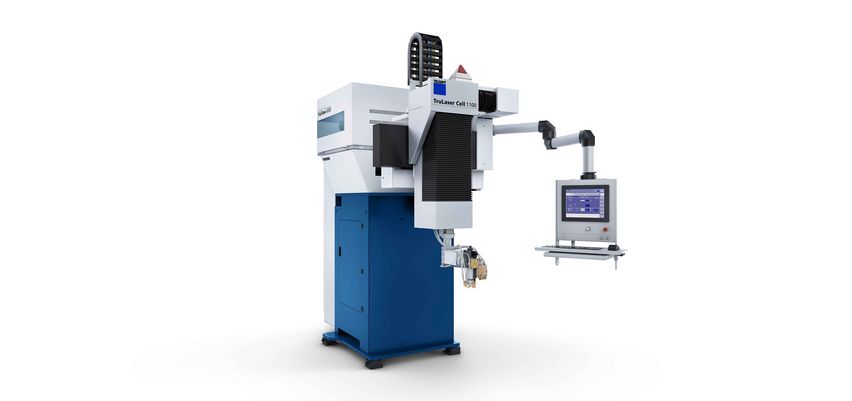

TruLaser Cell 1100 Tube laser welding system
In combination with the TruFiber, the TruLaser Cell 1100 T (Tube) enables efficient and cost-effective production of continuous components. With the latest laser and optical technology, the optimum welding process can be achieved for every material and every dimension. The automatic axis system makes it possible to react to different splitting situations in real time.

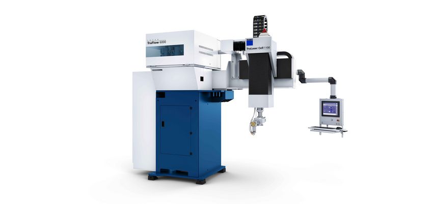

TruLaser Cell 1000 Tube Compact laser welding system
TruLaser Cell 1100 TC
The TruLaser Cell 1100 TC (Tube Compact) impresses with its simple operation, different design variants, and high welding speeds. By using the TruFlow CO2 laser, the production of your components can be achieved with the highest possible quality.

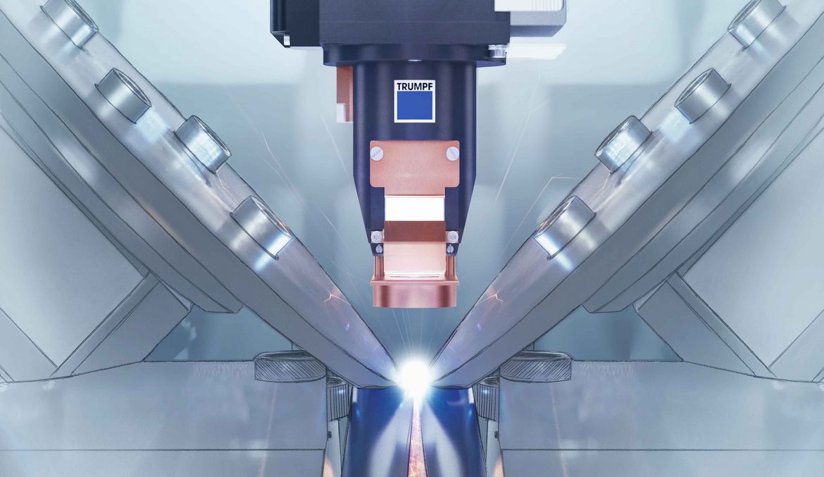

Laser welding process of a profile on the TruLaser Cell 1100
Laser-welded profiles
The TruLaser Cell 1100 has been specially developed for the endless laser welding of tubes and profiles. Its compact structure enables it to be integrated problem-free into an existing profiling machine. The concept enables the tube/profile welding machine to be converted to various product geometries with minimal idle times. The solid construction and flexible beam guidance system guarantee constant process conditions and the highest quality.

TruLaser Cell 1100
TruLaser Cell 1100 (CO2-Laser)
Axis travel range
X axis travel range 300/500 mm 300/500 mm
Z axis travel range 300/500 mm 300/500 mm
Q axis travel range ± 25 mm ± 25 mm
Maximum axis speeds
Maximum axis speed, axially parallel in X 5 m/min 5 m/min
Maximum axis speed, axially parallel in Z 5 m/min 5 m/min
Maximum axis speed of Q axis 3 m/min 3 m/min
Maximum axis accelerations
Maximum axis acceleration, axially parallel in X 1.5 m/s2 1.5 m/s2
Maximum axis acceleration, axially parallel in Z 1.5 m/s2 1.5 m/s2
Positioning accuracy
Positioning accuracy of linear axes (X, Z) 0.1 mm 0.1 mm
Laser
Maximum laser power 3000 W - 12000 W 3200 W - 15000 W
Available lasers TruFiber TruFlow

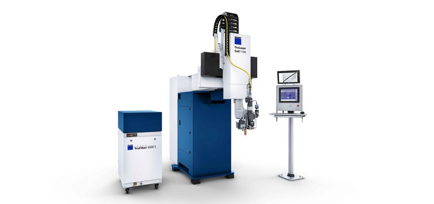

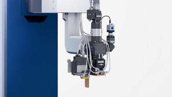

TruLaser Cell 1100 with fiber laser TruFiber 6000 S

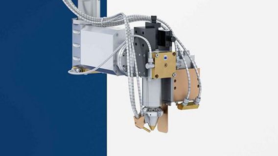

BEO D70-2
High-end fixed optics for continuous welding with solid-state lasers. Reproducible solution for highly demanding components. Includes alignment of the welding process on the component using VisionLine and gas flushing of the process zone using a metal vapor effect nozzle.

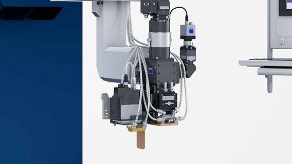

SeamLine
In the TRUMPF TruLaser Cell 1100 laser system, the SeamLine sensor controls the seam position. With alternating incident light and light section measuring procedures, the system reliably detects gaps or bends, and controls the position of the processing optics precisely and effectively across the workpiece.
