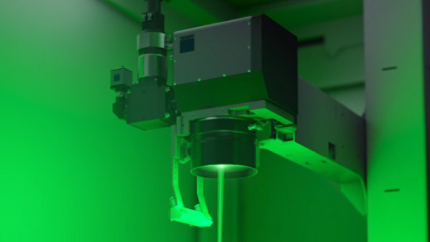

Green laser welds copper efficiently
In the next step, the electrode foils must be cut to size. These foils are typically between 6 and 14 micrometers in thickness. Ideal for this purpose are the short-pulse lasers from the TruPulse nano product range. In combination with an optical scanner system, these lasers are able to rapidly cut the foil to the required shape. A battery cell is formed by connecting a stack of connected copper and aluminum electrode foils – a job that can be done with a laser, for example. However, standard industrial lasers are only of very limited use in this area, as copper is highly reflective. TRUMPF has therefore developed a special TruDisk laser that operates at a short wavelength in the visible green spectrum. Using this green laser beam, copper foils for battery cells can be welded reliably and efficiently.

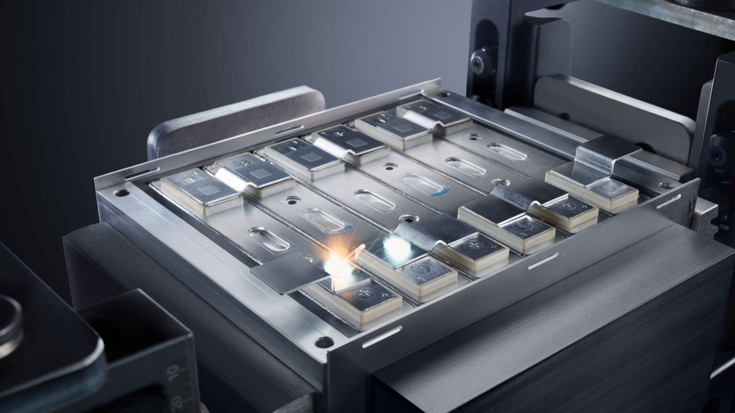

As a rule, a battery module is made up of many battery cells. These are connected to one another by means of busbars made of copper or aluminum. Material combinations and metal thicknesses can vary significantly, depending on the type of cell and its specific application. As a result, many different laser types are used for this purpose. These vary in wavelength, beam quality and power – but they are always in combination with an optical scanner system. The latter automatically guides the laser to the correct position and ensures it follows the required welding path.

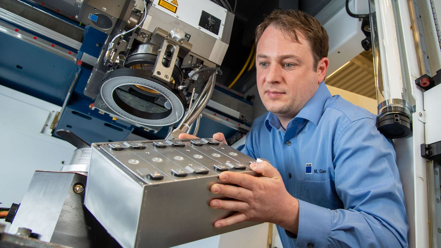

Busbar welding
Laser welding creates highly conductive and mechanically robust busbar connections.
Batteriemodul mit Mann
Battery module
As a rule, a battery module is made up of a large number of battery cells. These are connected to one another by means of busbars made of copper or aluminum.
Green laser
