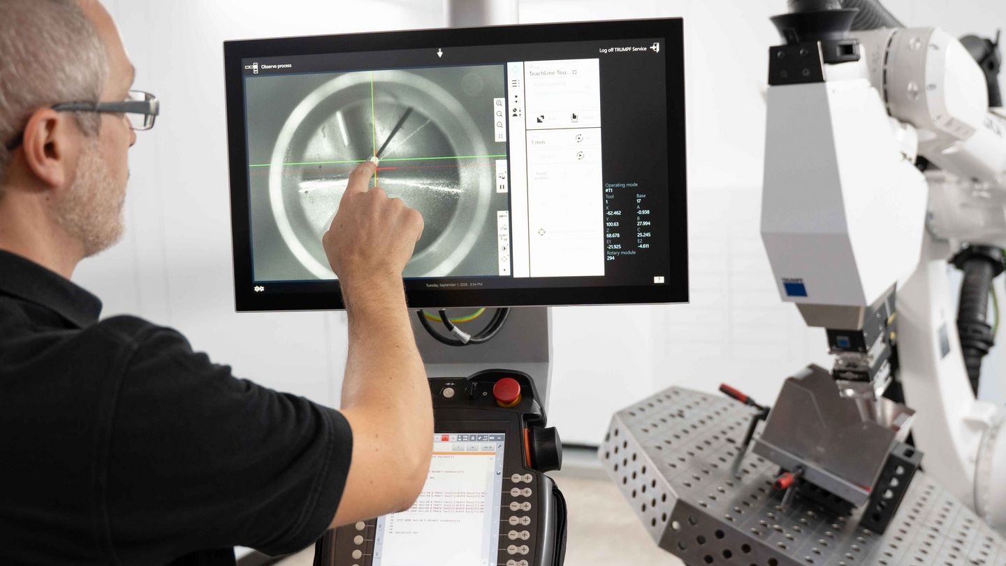

The new TruLaser Weld 3000 can be programmed directly at the machine in the conventional way or offline using the TruTops Weld software from another location such as an office. This ability to easily edit the program is particularly useful when working with frequently changing components. Employees can create new programs on the computer while the machine continues production.
In addition, welding programs based on CAD data are created significantly faster than with conventional programming. The “TeachLine Touch” function is used to correct minor deviations. Weld points can be repositioned simply by tapping on the machine screen. This reduces programming and setup time by up to 50 percent. Corrections are even easier with the “TeachLine AI” feature extension. An AI-based process detects deviations in the weld points and corrects the robot path according to the actual component configuration. This allows the system to be set up more quickly for new components. Another advantage of the new technology is that even less experienced employees can operate the laser welding cell.

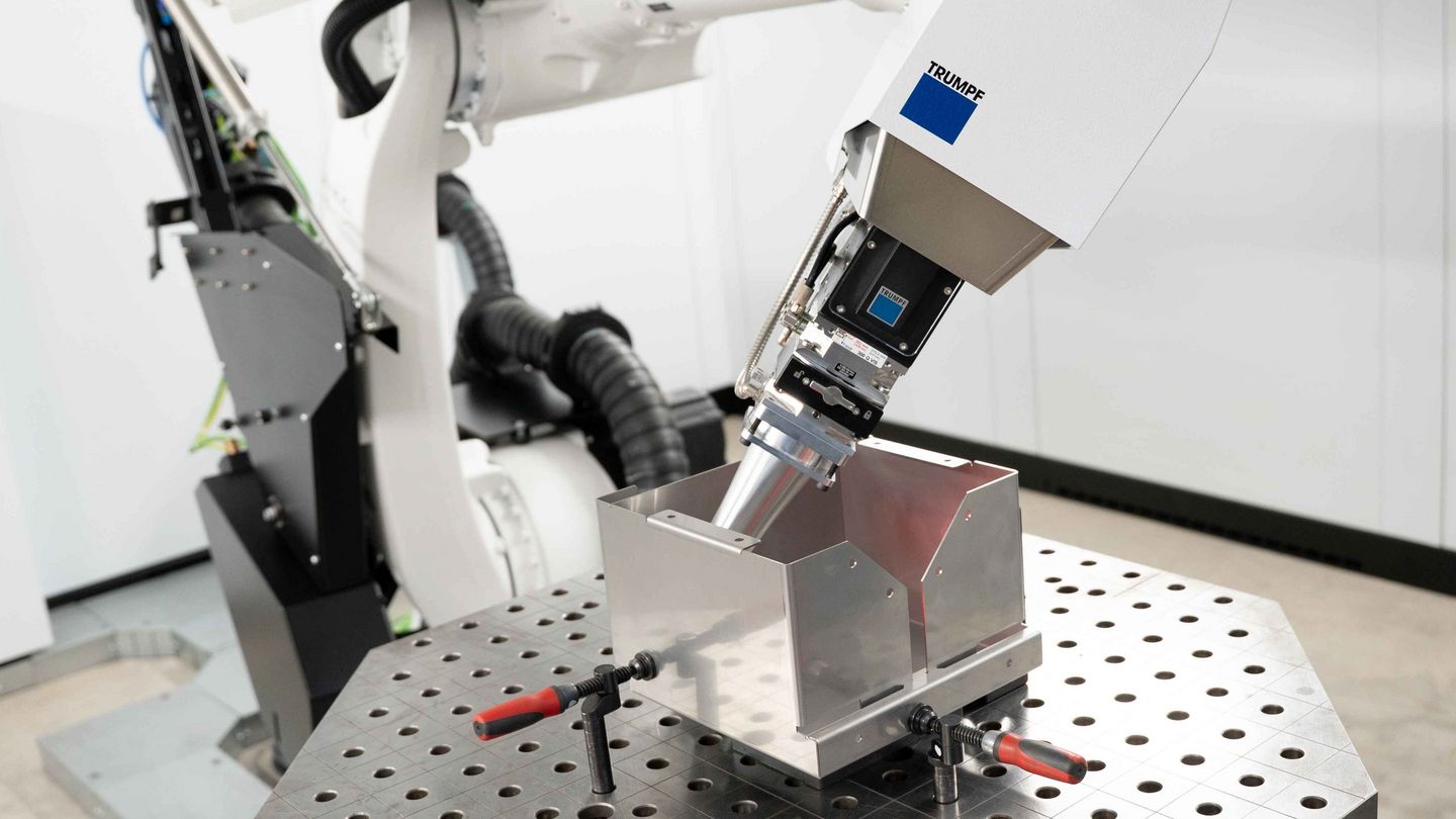

Smaller welding optics expand the range of parts that can be processed
Newly developed welding optics - approximately 40 percent smaller - expand the range of applications for the TruLaser Weld 3000. Thanks to its compact design, the welding robot can reach even hard-to-access areas within a component, such as the interiors of deep housings, crates or boxes. This enables users to automate the production of a wider range of parts and reduce manual rework.

Smaller welding head
A newly developed welding optic—approximately 40 percent smaller expands the TruLaser Weld 3000’s range of applications. This makes it particularly well-suited for manufacturing deep components such as control cabinets. (Source: TRUMPF)

TeachLine Touch
The TeachLine Touch software allows the welding cell to be set up and programmed up to 50 percent faster. (Source: TRUMPF)
