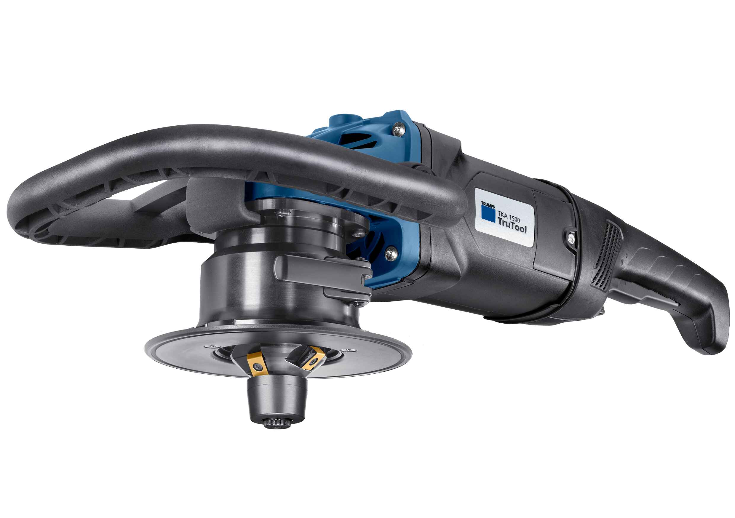

Farmington, Conn., November 9, 2023 – TRUMPF has introduced a new TruTool TKA 1500 edge milling tool with updated features to reliably create sheet metal edges with repeatable accuracy and without any rework. The redesigned deburring tool is now available with a new cutting mount and guide fence for increased applications and safety. Additional ergonomic enhancements to the TKA 1500 contribute to the tool’s low-vibration and smooth operation.
Ergonomic handling, optimum feed rates
TRUMPF designed the TKA 1500 for operator safety and ergonomics. The tool’s handle shape, size and positioning ensure safe machine guidance, and support the chamfer quality. The large electric hand tool is equipped with a powerful 2,600-watt motor and adapted gearbox, so it is very quiet to run, and operators can generate a high-quality chamfer reliably, and for longer periods of time without fatigue. Design improvements have reduced vibrations and ensure that an optimum feed rate can be achieved. This reduces the amount of wear and tear, increasing durability.
More applications, easier adjustment
The TKA 1500 comes with a standard, 45-degree multi-edge cutter mount, and depending on the application, operators can also choose optional multi-edge or radius multi-edge cutter mounts in 30-degree, 60-degree, and now 37.5-degree angle positions. The new multi-edge cutter mount can chamfer 37.5-degree angles, which is particularly useful when processing tubes. The new edge milling tool is suitable for an increased variety of applications. It is suitable for deburring, rounding, or chamfering end edges. The tool can also be used to prepare parts for powder and paint coatings, as well as welded seams.
The bevel length can still be adjusted without tools, although now it is easier to adjust since the new design of the TKA 1500 provides an unrestricted view of the dial ring. Operators can use the tool to create clean visible edges, break off sharp edges, add a radius, or prepare a weld seam.
Facilitated processing, added protection
Another highlight of the new TKA 1500 is the unique guide fence, which is made of stainless steel and is particularly beneficial when processing long, straight sheet metal and outer contours. The guide fence makes it easier to run into the sheet metal and control the processing direction. The guide fence also provides practical protection against chips, directing chips downward in a controlled fashion to increase occupational safety. This practical standard accessory is assembled in seconds without any tools. It is also helpful that the shape, size and positioning of the handle can be adjusted ergonomically to one another, further supporting the safe and precise control of the machine.

Updated TKA 1500 Creates More Custom Bevel Lengths
With the new TKA 1500 beveling tool you can create custom bevel lengths of up to 0.43 inches with 30°, 37.5°, 45° and 60° angles and adjust the desired bevel length without tools. (Source: TRUMPF)
New Guide Fence for Safer Beveling
A highlight of the new TKA 1500: The stainless steel guide fence makes it easier to run into the sheet metal and provides practical chip protection (Source: TRUMPF)
Closer look at the Guide Fence
A new accessory for the TKA 1500, Helps with the run-in to the sheet metal and simultaneously acts as chip protection. (Source: TRUMPF)
