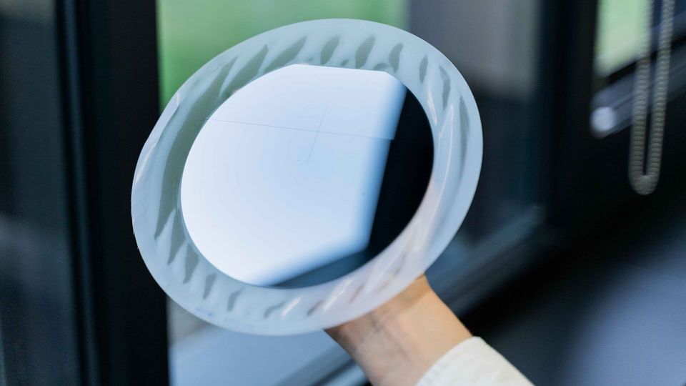

Blanker_Wafer
The wafer: At first it is nothing more than a shiny disk, but it becomes hundreds to thousands of chips.

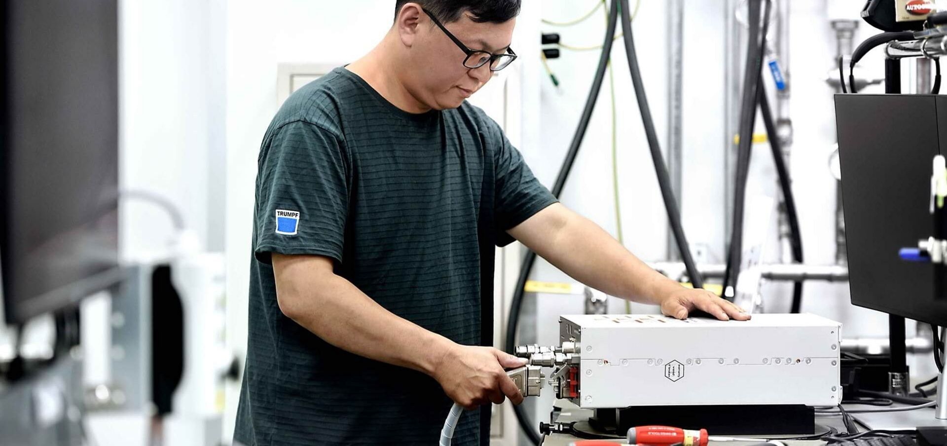

Generator
Generators from TRUMPF tame the current and set the amperage, voltage and frequency to a highly precise value.

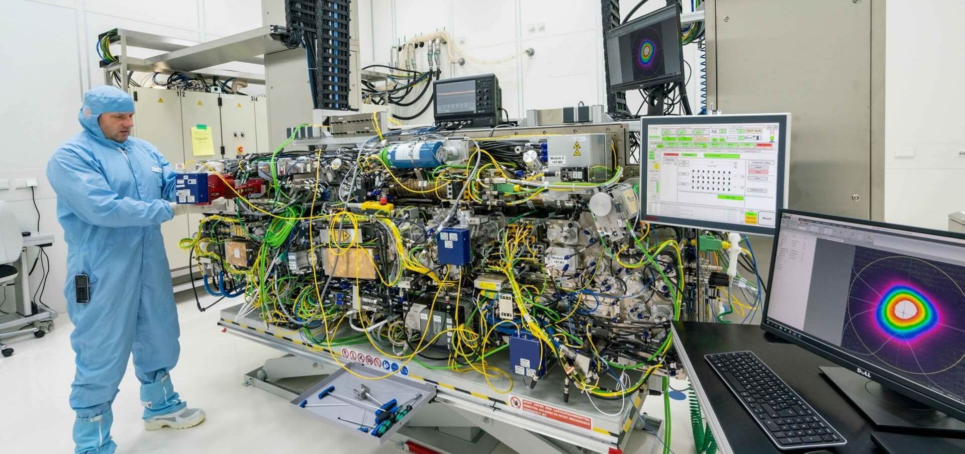

EUV_Laser_Teil
The heart of chip production: a component of the world's most powerful pulsed industrial laser, which is used to generate light to enable EUV lithography.

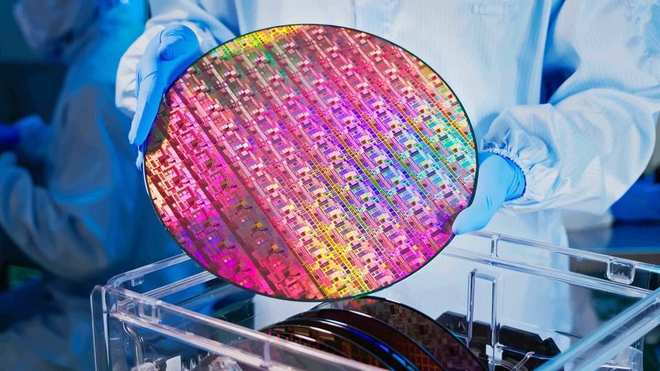

Wafer
Up to thousands of individual chips are produced from one wafer.
