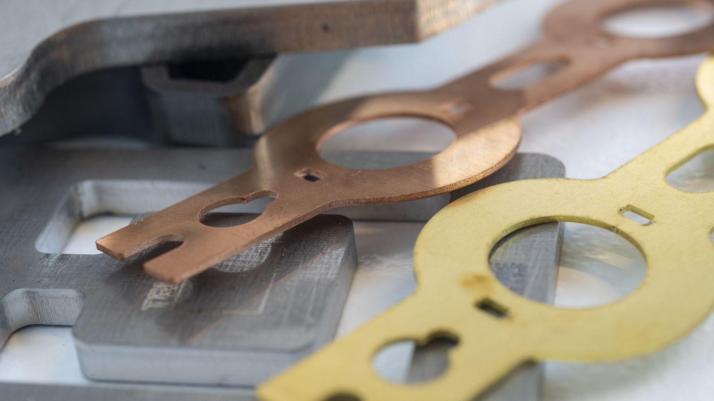

Material diversity
The new TruLaser Series 1000 can process a variety of different materials, including stainless steel, mild steel, aluminum and copper. (Source: TRUMPF / Martin Stollberg)
