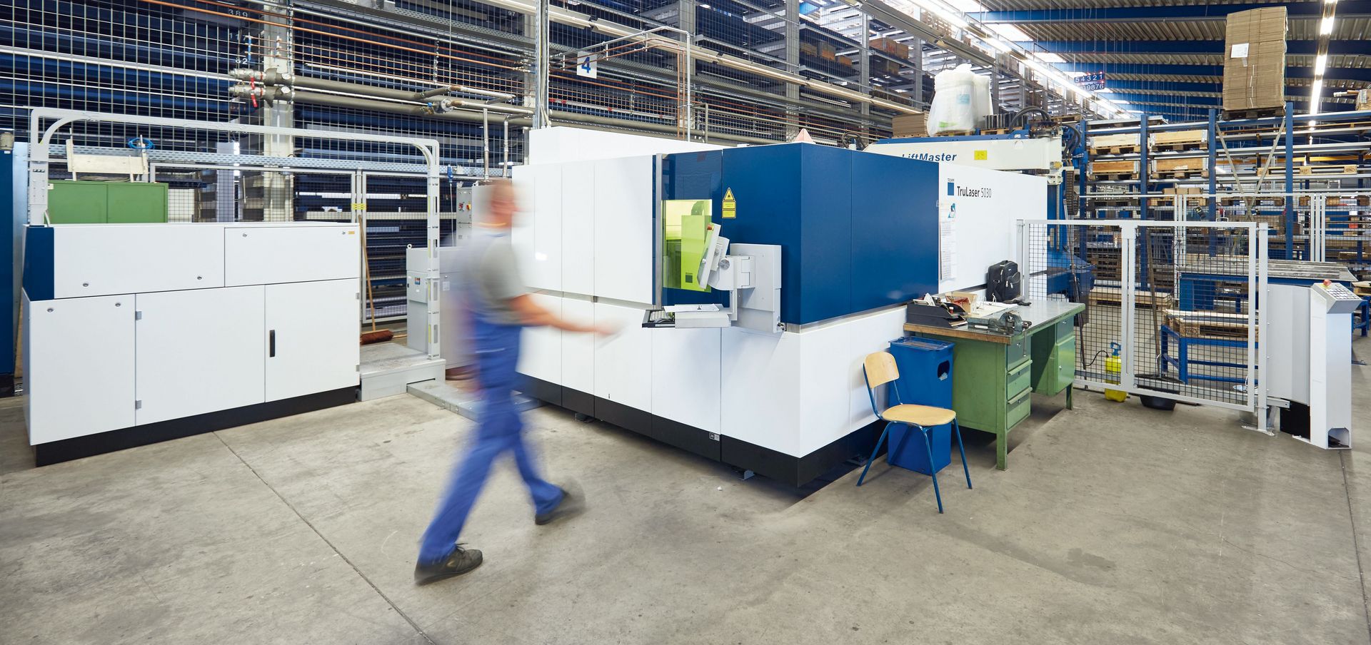

A Stopa storage system takes care of supplying materials while a LiftMaster makes it easier to handle parts. (Picture: Claus Langer)
The BrightLine fiber option produces amazing cut edges at impressive speed, when working with mild steel 25 millimeters thick. (Picture: Claus Langer)
The machine was set up and has run absolutely smoothly since the very first moment. “You can’t get any better than this,” say Hermann Schickling. (Picture: Claus Langer)
