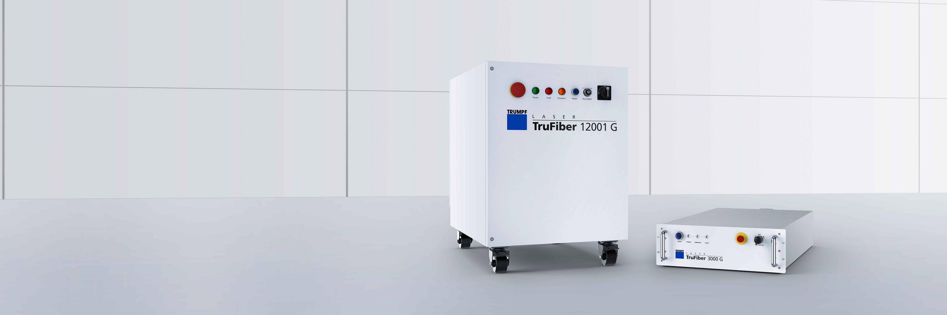

TruFiber G
Our economical laser source for integrators
| Product options TruFiber G | Laser power range | Wavelength | Typical beam quality | Dimensions (W x H x D) | Electrical connection (voltage) | Electrical connection (frequency) | Interfaces |

The purist
For those who are not looking for a complete package, but simply a reliable laser: The TruFiber G series delivers everything integrators need for precise cutting and welding - compact, cost-efficient and reliable. You can easily integrate the laser into your cutting and welding machines and rely on the proven quality of TRUMPF. We also use the TruFiber G in our 2D laser cutting machines from the TruLaser Series 1000.
What makes the TruFiber G so special
The TruFiber G is specially designed for cost-conscious integrators - with a focus on the essentials: Performance and security at an attractive price.
With active power regulation, the laser power remains stable at 100% over the entire service life. The system monitors and regulates the output power automatically - for consistently high processing quality.
Application-specific beam shaping options optimize your results. VariMode allows you to adjust the beam profile to the thickness of the material to be cut. BrightLine Mode enables high-quality weld seams with minimal spatter formation.
The TruFiber G meets the highest safety standards - up to PLe depending on the model - and is supported worldwide by our TRUMPF service network. Integrators and operators benefit from 24/7 support and fast response times.
