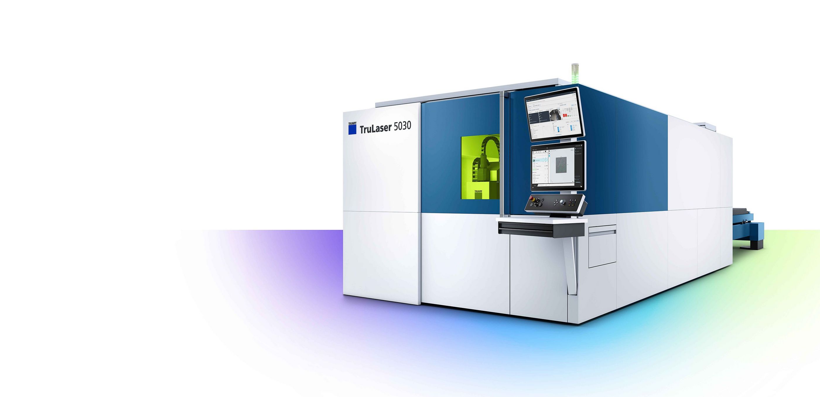

TruLaser 5030 fiber
TruLaser 5030 fiber
2D laser cutting machines
TruLaser 5030 / 5040 / 5060
The Flagship - process reliability, digital, supportive
