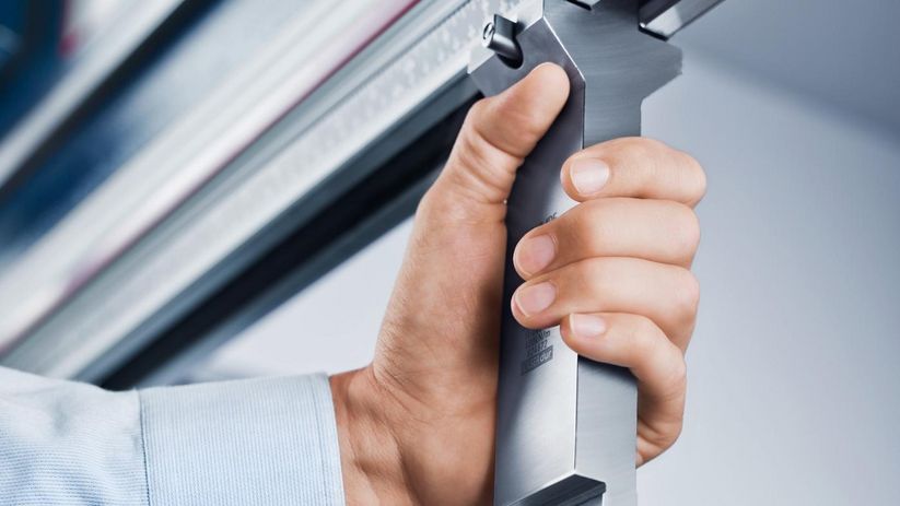

Lightweight bending tool for the Comfort model
For tools up to 12 inches long, lightweight tools with a weight saving of more than 30% are equipped with the Safety-Click as standard. This reduces the setup time and relieves the strain on the operator.
