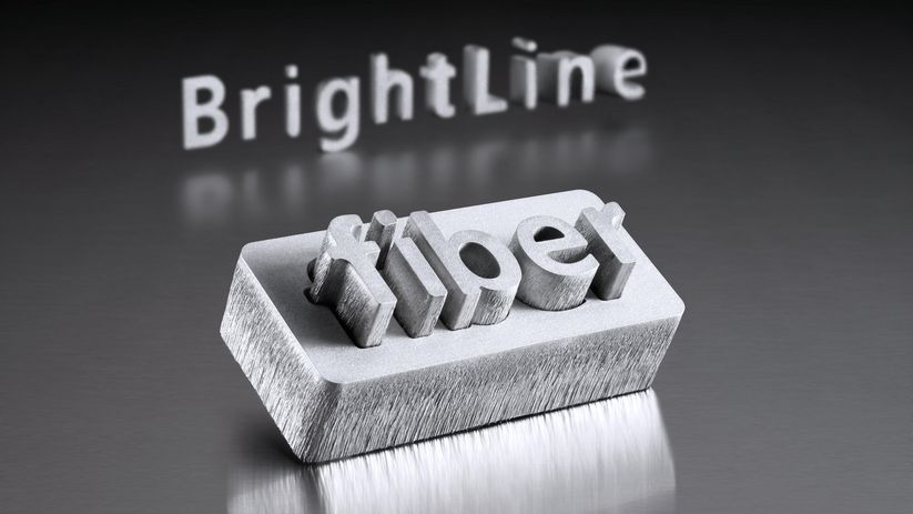

BrightLine fiber – High-quality cutting
BrightLine fiber turns the solid-state laser into a universal tool: The function provides you with high-quality cutting results over the entire range of sheet thicknesses. Furthermore, all of the advantages of the solid-state laser are retained, in particular the high speeds, during thin sheet processing.
