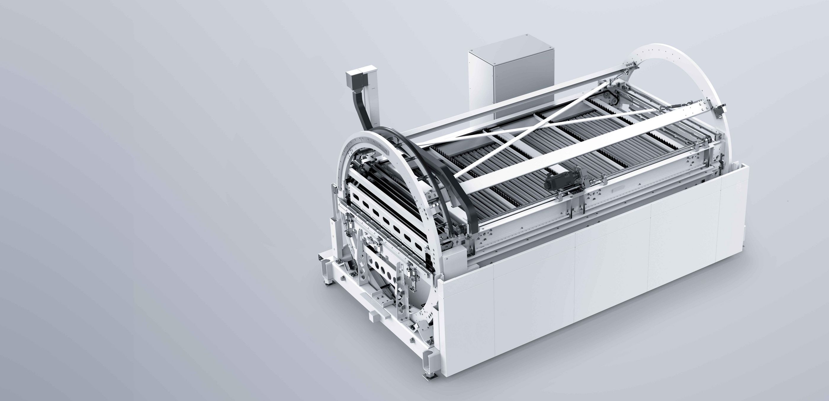

Turn sheet metal quickly and carefully – ensuring minimum cycle times and direct linking
Turning made easy

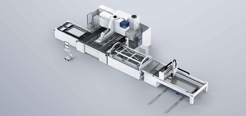

With the bending automation turning station, you can complete the direct link between the loading and bending operation processes: SheetMaster loads, the turning station turns the pre-cut part, and TruBend Center 7030 bends it. This speeds up the entire process. Regardless of whether the parts are small or large, the device turns a large variety of parts carefully and safely.
Minimum cycle time
The turning and alignment of parts parallel to production significantly reduces cycle times.

Gentle on the material
The special design with brushes guarantees the gentle processing of your parts.

The compact and modular turning station is inserted directly between the TruBend Center 7030 and SheetMaster.

SheetMaster for loading and unloading
The turning station is a significant part of the direct link.
Wendestation
Minimum part size 350 mm x 200 mm
Maximum part size 3123 mm x 1500 mm
Minimum sheet thickness 0.5 mm
Maximum sheet thickness 4 mm
Maximum part weight 120 kg
Zykluszeit für Drehung (Ø) 35 s
Max. Vor-Verformungshöhe 4 - 5 mm
Gesamtgewicht 3200 kg
Dimensions
Height 2140 mm
Length 4075 mm
Width 2240 mm
