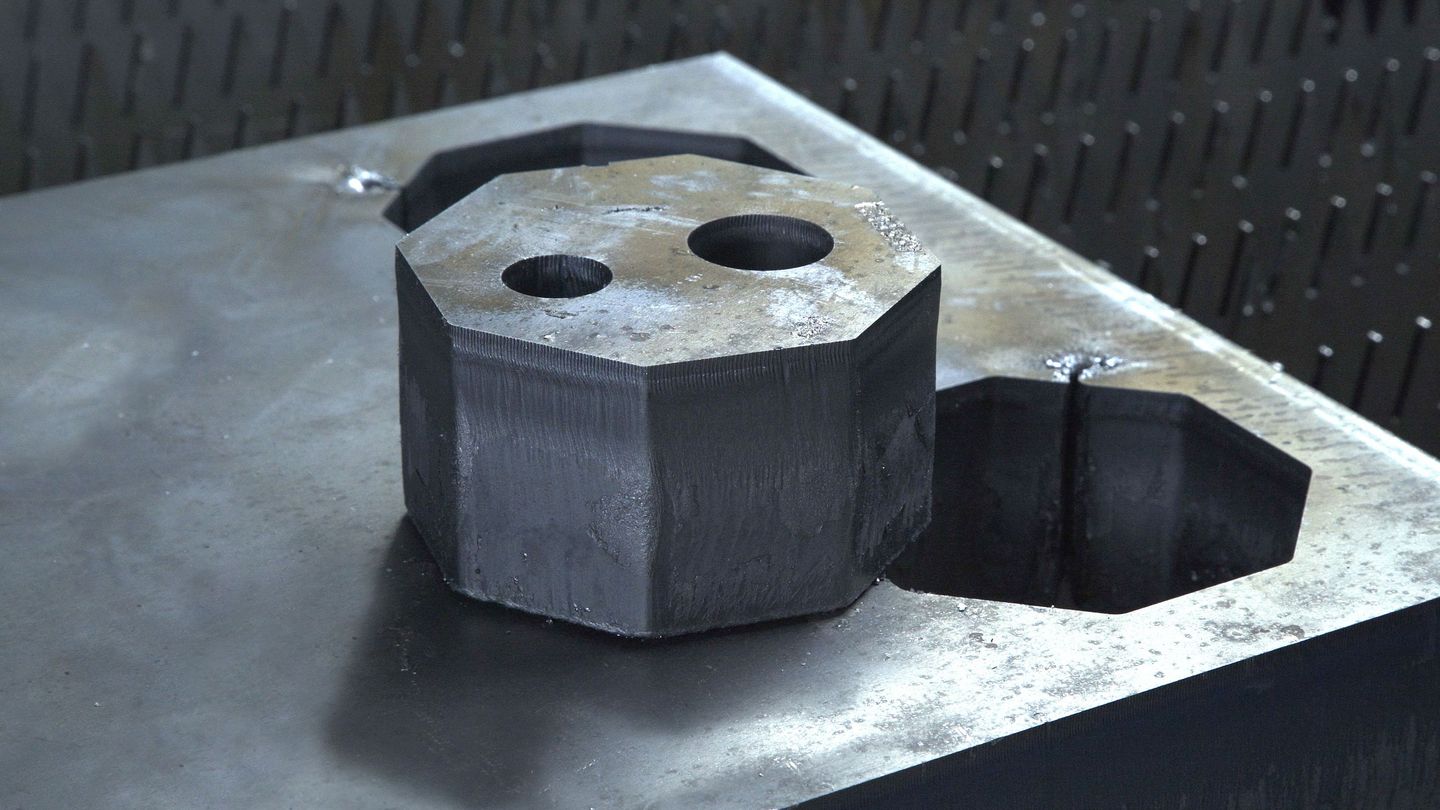

With a 12 kW laser, sheet-metal processors are able to cut sheets of mild steel to a maximum thickness of 9/16 of an inch when nitrogen is used as a cutting gas. In order to cut thicker parts, it is necessary to add oxygen. This leads to the formation of an oxide layer on the cut edges of the part. These must then be removed either by machine or by hand – a process that is laborious and time-consuming. Alternatively, companies can use a plasma machine to cut thick parts. This, however, is much slower and less precise than a laser-cutting machine. By contrast, the 24 kW machine can handle sheet thicknesses of up to 3/4 of an inchwhile using nitrogen. As a result, there is barely any need for reworking and productivity therefore increases. At the same time, the increased laser power improves the quality of cut parts, especially for medium and high sheet thicknesses.

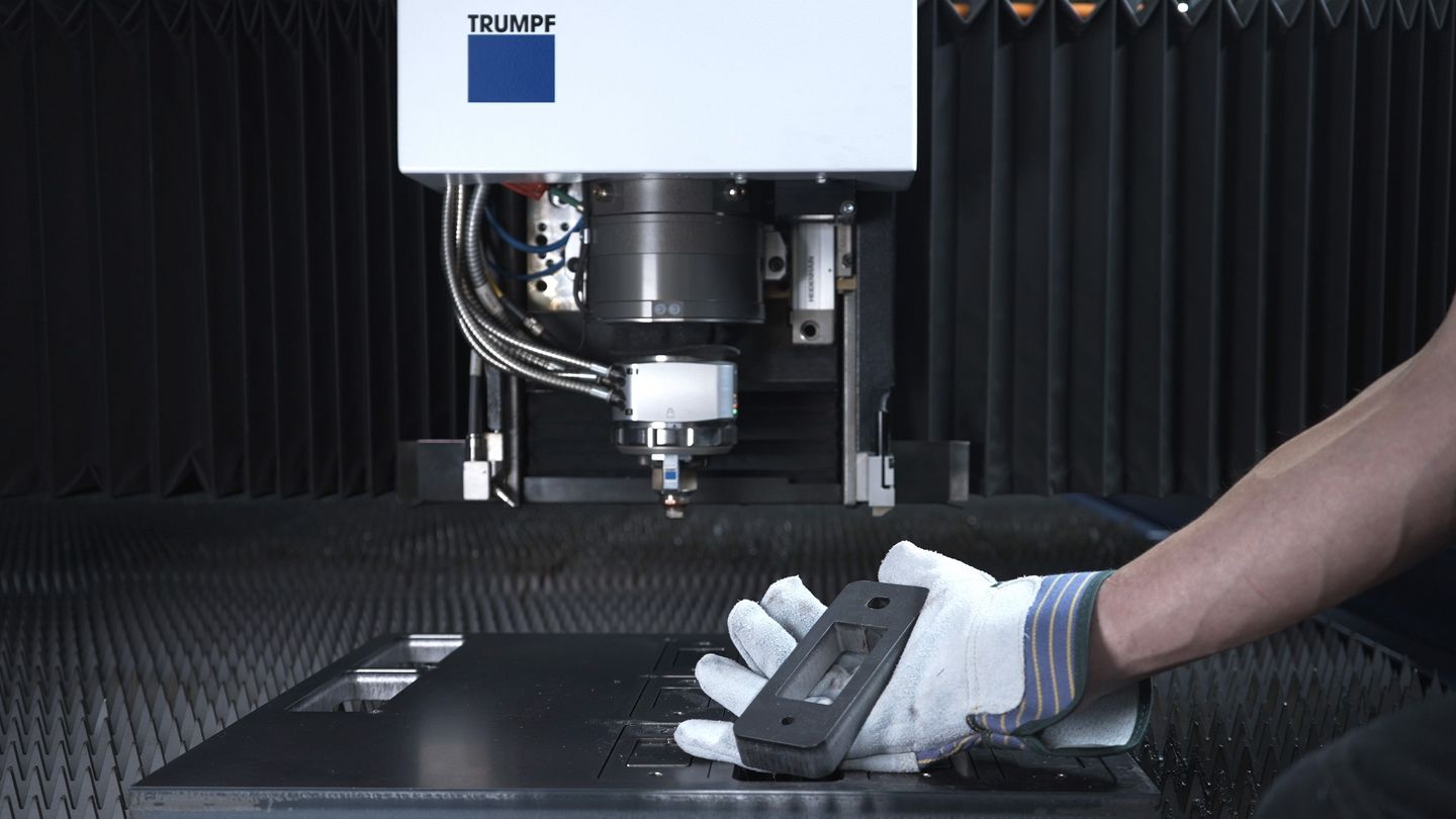

24 kW laser
In combination with the patented cutting unit of the TruLaser 5000 series from TRUMPF, a new 24 kW laser cuts components up to three times faster.
High sheet thicknesses
Equipped with a 24 kW laser, the TruLaser 5000 series cuts medium and high sheet thicknesses efficiently.
