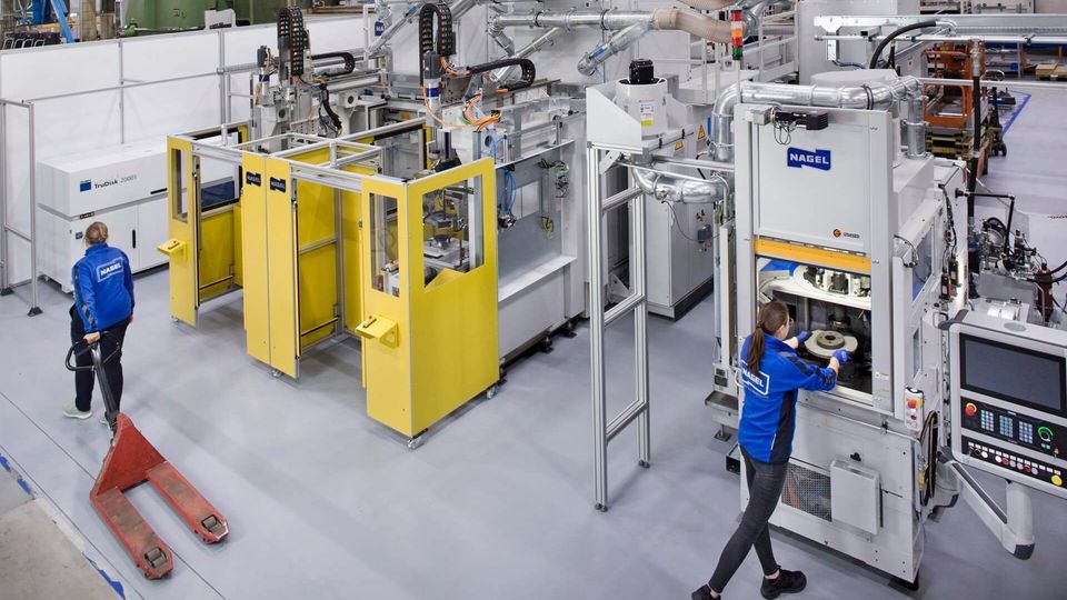

A cast-iron car brake disk rotates on the machine's rotary table under laser optics and seven powder feed nozzles. The high-speed laser deposition welding cell, called NaCoat, applies two layers. "In thirty seconds of processing time, the surface layer looks like a chocolate bar with whole nuts under the microscope: The hard particles stick out," explains Lott. "That would not yet reduce particulate matter."

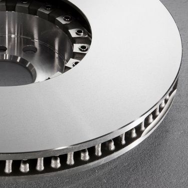

So the brake disk is placed in the NaGrind grinding machine, which grinds the disk smooth with 36 diamond tools. The ultra-hard car brake disc is ready. The wear layer is around ten times harder than standard cast washers and lasts much longer.
On the left, a disk laser feeds two high-speed coating machines. On the right, the panes are given the finishing touches.

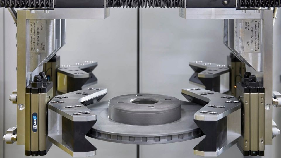

  1. The grippers grab the brake disk with its raw, untreated cast iron surface and bring it into the coating chamber.

  3. Cross grinding: The brake disk is given its final surface and geometry in the grinding machine.
