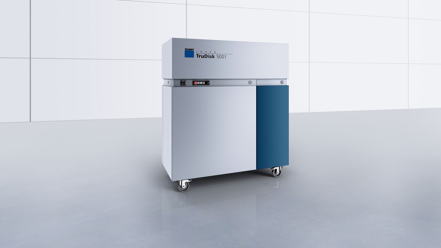

New generation of disk lasers
New-generation TruDisk disk lasers are extremely compact, with a footprint of less than one square meter.

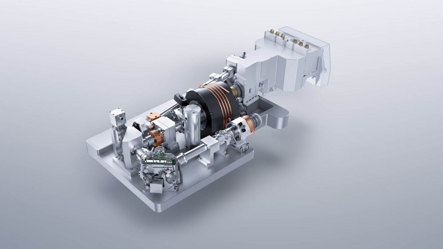

Scheibengeometrie des TruDisk

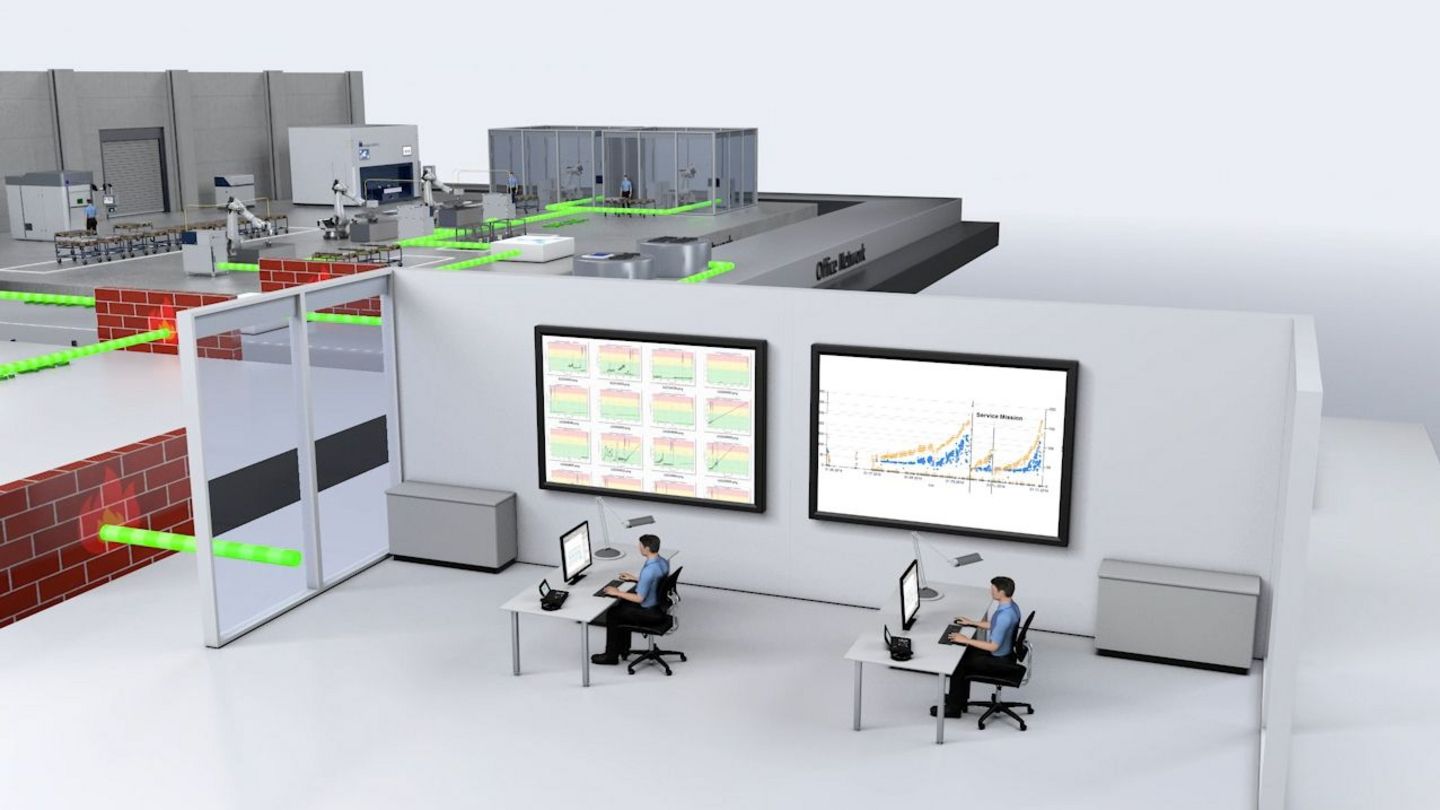

Condition Based Services
TRUMPF Condition Based Services help ensure reliable production processes with maximum availability.
