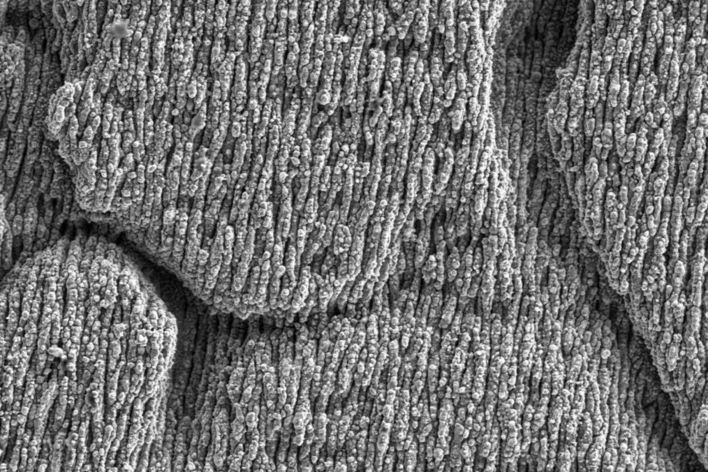

For the purposes of UDI, it was possible to use the ultrashort pulse laser (USP), which has been in use for years, and develop it further. "We already had the laser source which could produce a mark with utmost corrosion resistance in-house," says Conzelmann. The developers relied on black marking for the best possible contrast. In this process, a laser fires at the surface with extremely short pulses, creating structures within the nano range. The rough surface reduces the scattering of light, and the result is an extremely dark, high-contrast mark which can be easily read from various viewing angles, and is therefore considered "gaze-constant".
