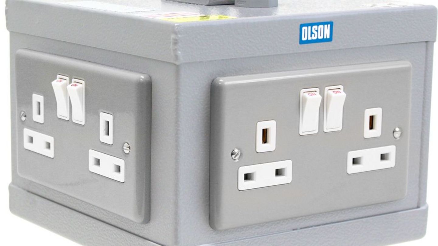

Founded in 1961, family-run Olson Electronics today employs 27 people at the company’s ISO9001-accredited facility in Stanmore, northwest London. By adopting an in-house design and manufacturing strategy, Olson Electronics assures the superiority of its components, development methodologies and quality testing procedures.  Many of the PDUs manufactured at Olson Electronics are rack-mounted for use in data centres and other IT applications. Desk-mounted PDUs are also popular, typically for schools, colleges and laboratories. Another important industry is healthcare, in particular mobile trolleys for hospitals that require an electrical supply. In short, the company sells its PDUs to anyone who needs one, even household consumers can acquire them from Amazon or the company’s website, with products shipped worldwide.
Alongside over 30 different standard catalogue product ranges - including intelligent PDUs with monitoring and switching capabilities – many of the products manufactured at Olson Electronics are bespoke, which provides important market differentiation and opens doors to new business.

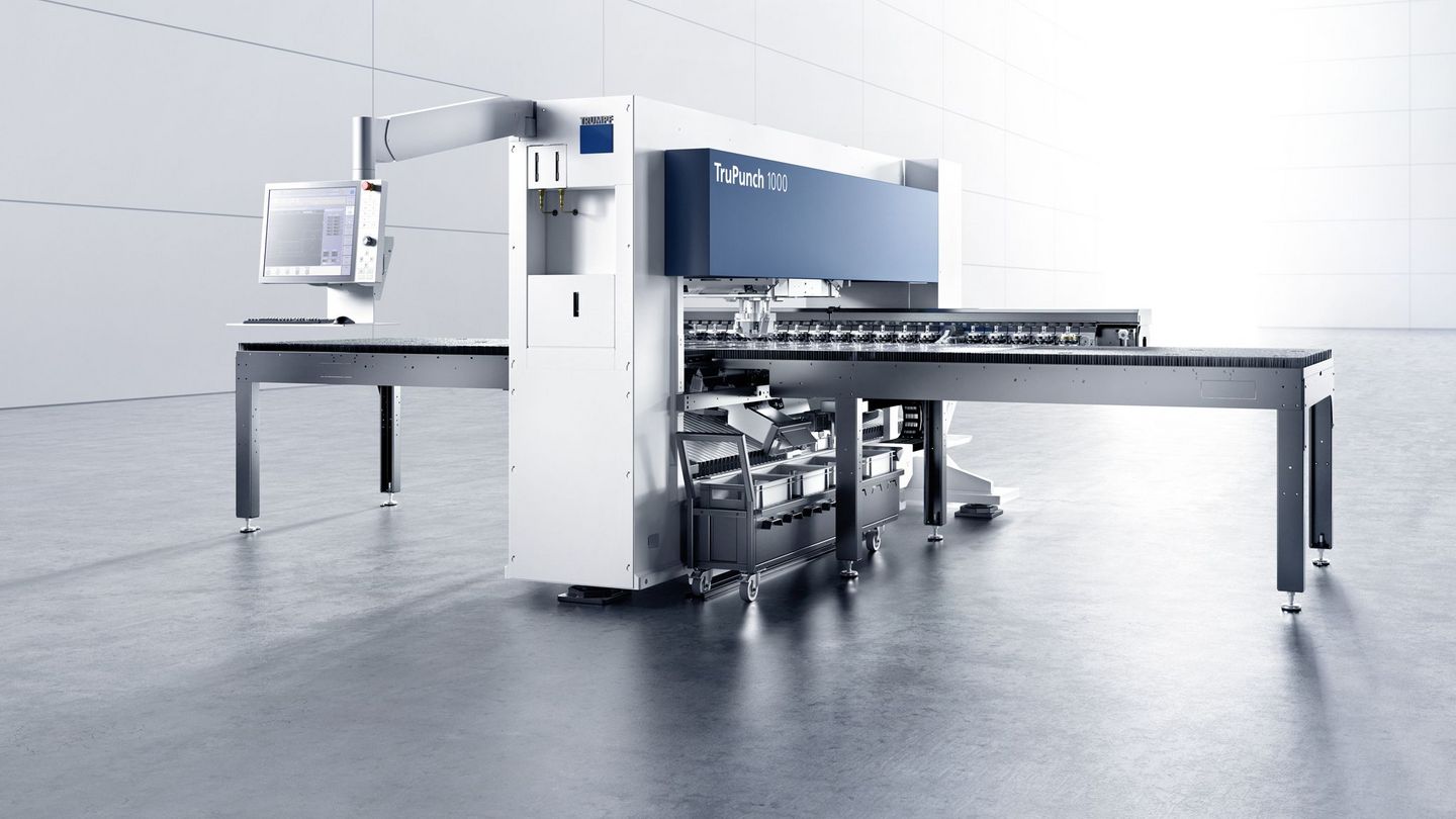

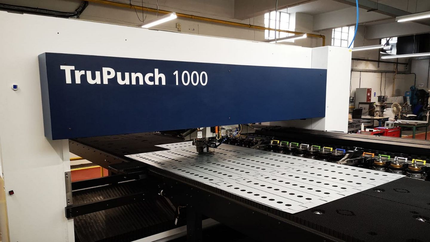

The compact entry-level TruPunch 1000 is extremely flexible, cost-effective and quick, processing sheet up to 6.4mm thick at up to 600 strokes per minute. Importantly, innovative Delta Drive dynamics eliminate the need for the sheet and support table to move in the Y axis, while full automation is possible in line with business development.
Installed in April 2022, the TruPunch 1000 at Olson Electronics is predominantly processing galvanised steel or zintec from 0.9 to 1.5mm thick, sometimes up to 2mm. Batch sizes extend from 1-offs up to thousands. All enclosures are programmed using TRUMPF TruTops Boost software. The company creates models in 3D modelling software and exports them into TruTops Boost for automated disassembly. By activating the ‘Boost’ button, Olsen Electronics can take advantage of a quicker process from geometry to NC program, while the software also allows more efficient material use thanks to a shared order pool and ‘Lean Nest’ nesting processor.

Up to 6.4mm thick at up to 600 strokes per minute. Importantly, innovative Delta Drive dynamics eliminate the need for the sheet and support table to move in the Y axis, while full automation is possible in line with business development.
TruPunch 1000 (S19)
TRUMPF TruPunch 1000
