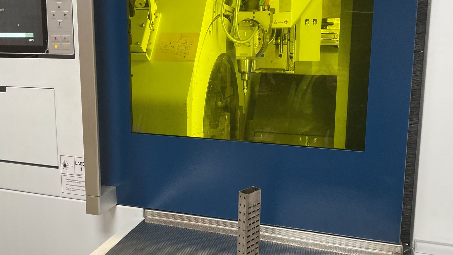

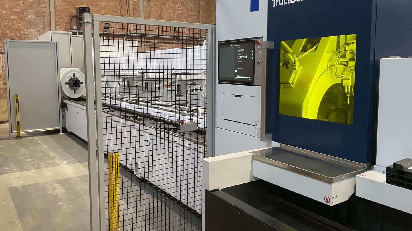

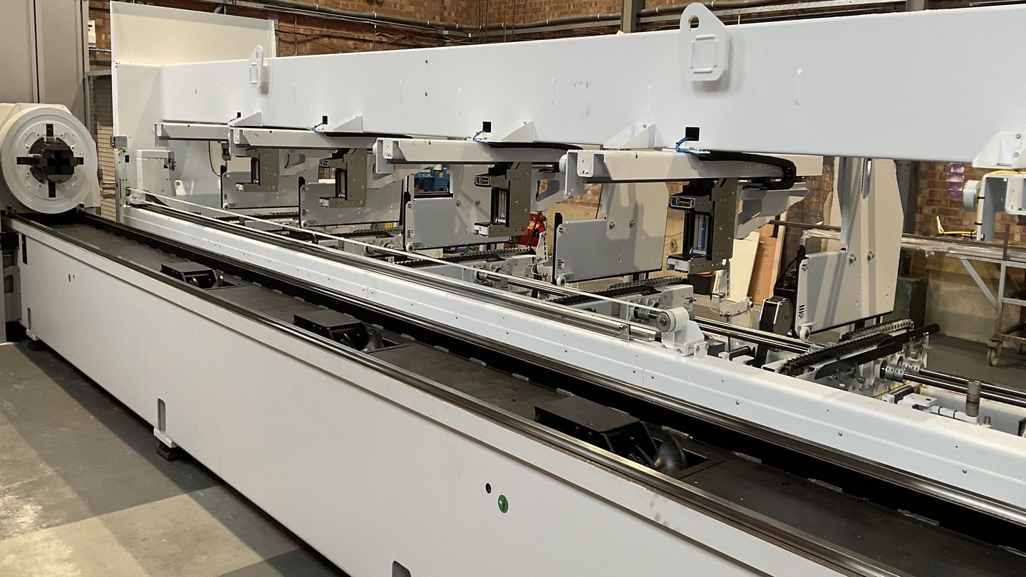

TruLaser Tube 3000
The TruLaser Tube 3000 at LASERCELL
Detailed view of the TruLaser Tube 3000
The whole TruLaser Tube 3000
