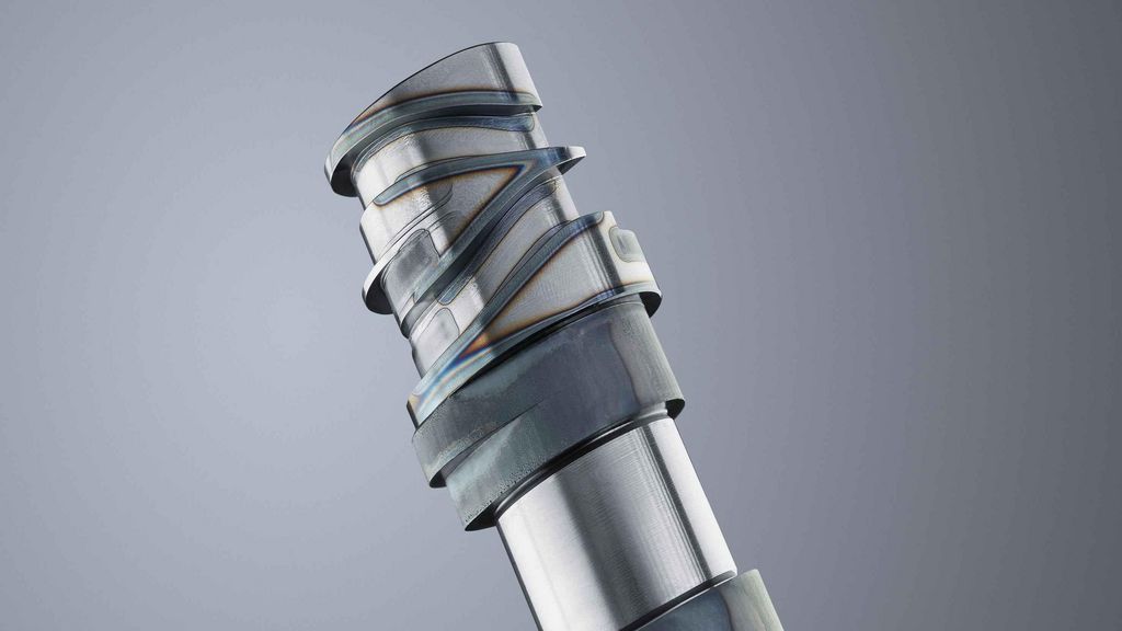

Case hardening of a camshaft
The service life of a camshaft is significantly extended by laser hardening. Different levels can be processed in parallel due to the large depth of focus.
