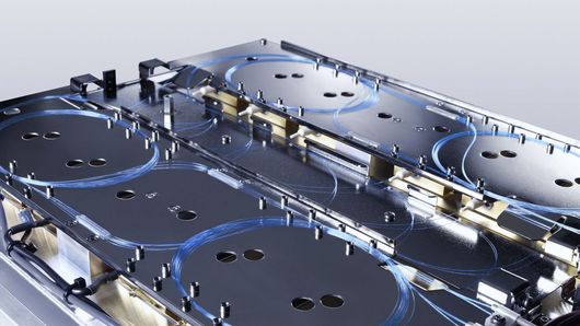

The e-mobility sector faces the great challenge of manufacturing fuel cells safely, economically and reproducibly on an industrial scale. This is exactly where TRUMPF lasers come into their own. The highest requirements for a repeatable welding process apply when joining metallic bipolar plates for PEM fuel cells. Media-tight, highly precise weld seams are achieved which have high mechanical stability at the same time. Thanks to large scan field sizes and highly precise positioning of the bipolar plates, our customers benefit from maximum flexibility and precision.
The programmable TRUMPF focusing optics PFO 3D increase the process reliability and quality during the welding process thanks to intelligent sensor systems.
Welding metallic bipolar plates with TRUMPF lasers
Many challenges – one partner: TRUMPF continually develops and conducts research to provide industrially mature laser solutions for safe and high-quality joining of thin materials.
In order to weld the thin metallic plates (70 to 120 µm) so that they are gas-tight without penetrating them, TRUMPF ensures precise positioning and clamping of these plates thanks to its extensive application know-how and actively supports its customers in their development projects.
Welding bipolar plates involves a great deal of inspection effort in terms of tightness and stability. TRUMPF provides an integrated sensor technology which is constantly developed further in line with demands in order to monitor and ensure the processes and quality and to reduce the subsequent inspection expenditure to a minimum.
TRUMPF singlemode lasers (TruFiber) in combination with PFO scanner optics are predestined for joining the thin half-shells of the bipolar plates at high welding speeds. Typical requirements include laser power of 500-1,000 W IR Single Mode and a laser spot diameter of 30-50 µm on the workpiece with a large scan field available at the same time, so that it is possible to weld as many of the long and numerous welds uniformly in one position with repeatability.
