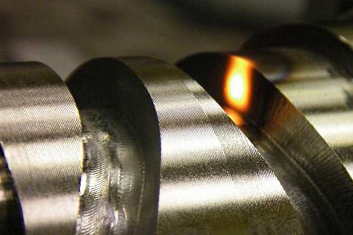

The biggest challenge of internal diameter (ID) cylindrical grinding is the limited space between the part and the tool. It’s not easy to accommodate a conventionally produced coolant nozzle that meets all the requirements — and in the case of very small holes it’s often impossible. That’s why, in practice, manufacturers tend to carefully inject the lubricoolant required for grinding from the outside. That makes the ID cylindrical grinding process very slow, and it poses a risk that not enough lubricoolant will reach the machining site. This results in higher cycle times and correspondingly reduced productivity as well as high scrap rates due to parts suffering thermal damage. Dirk Friedrich, owner and CEO of the company Grindaix, was far from satisfied with this solution.
