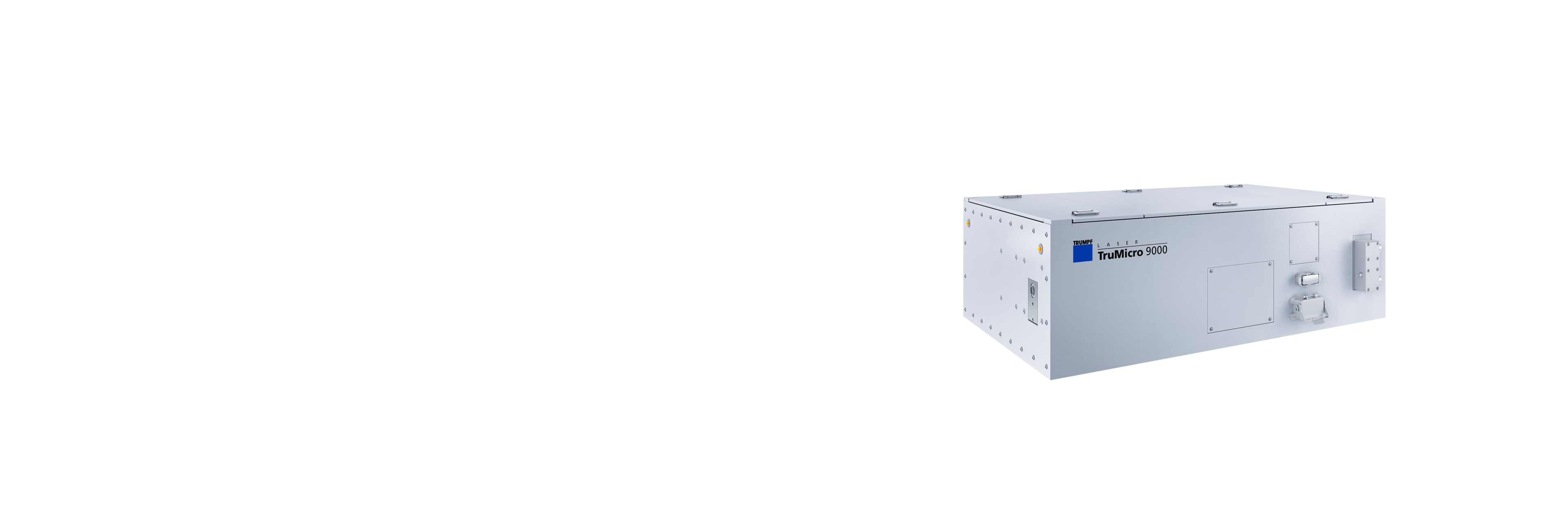

TruMicro Series 9000 ultrashort pulse laser
Our pioneer - groundbreaking microprocessing of large surfaces with 1 kW power
1000 W Average power
1030 nm Wavelength
1 - 20 ps Pulse duration
10 mJ at 100 kHz Max. pulse energy
Product options TruMicro Series 9000 Average Power Beam quality (M²) Wavelength Pulse duration Maximum pulse energy
TruMicro 9010
1000 W < 1.3 1030 nm < 1 ps 10 mJ bei 100 kHz
Large-scale microprocessing
– with 1 kW laser power
The TruMicro Series 9000 achieves 1 kilowatt of laser power - a world first in the ultrashort pulse range. Combined with the high pulse repetition frequency, this enables microprocessing over large areas. Using appropriate scanners, you can distribute the pulsing across the component at speeds of up to one kilometer per second, thus converting the high pulse repetition frequency into correspondingly high processing speeds. Alternatively, the high laser power can be distributed across multiple processing areas using beam splitters or beam-shaping elements. This enables you to scale processes such as structuring, cleaning, removal, or cutting cost-effectively down to the square-meter range.
