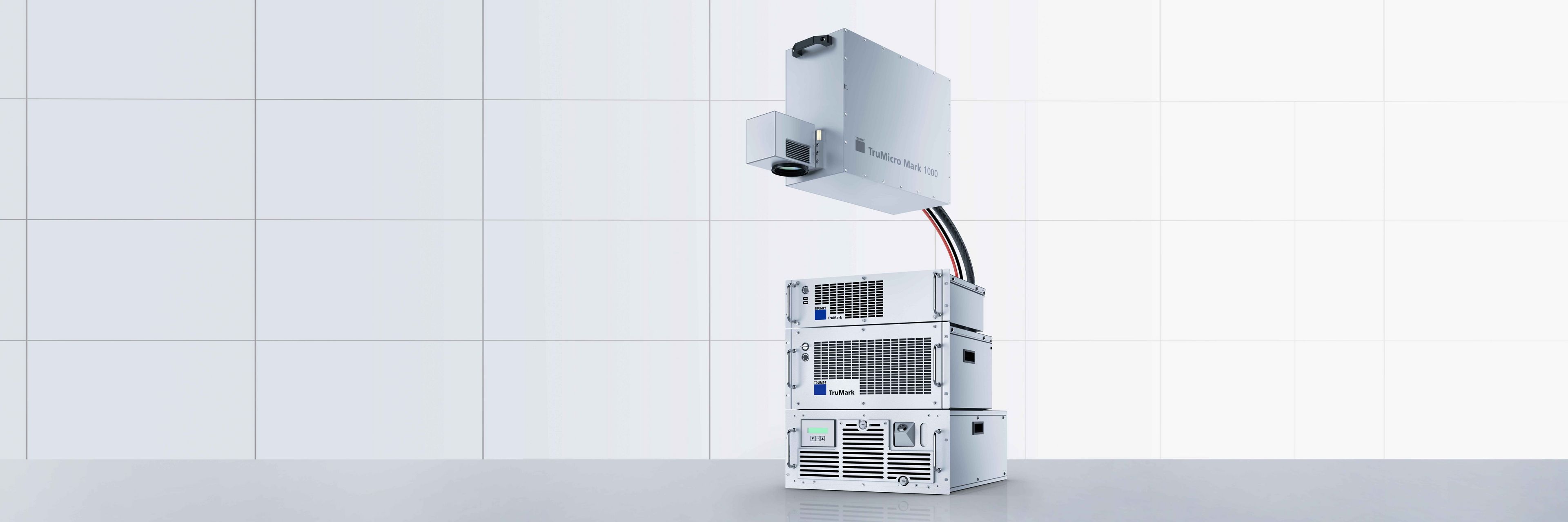

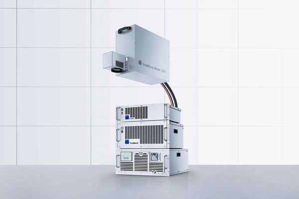

The lasers in our TruMicro Mark series can cold-process materials by combining ultra-short pulses and an extreme peak pulse power, enabling you to produce deep black, high-contrast markings of the highest quality and precision - right through to the creation of micro and nanostructures. You can choose between two model variants to suit the requirements of your applications. The TruMicro Mark 1020 enables you to process complex 3D objects, while the TruMicro Mark 2030 can be precisely adapted to a wide range of materials and tasks thanks to variable pulse durations from 400 femtoseconds to 20 picoseconds.
