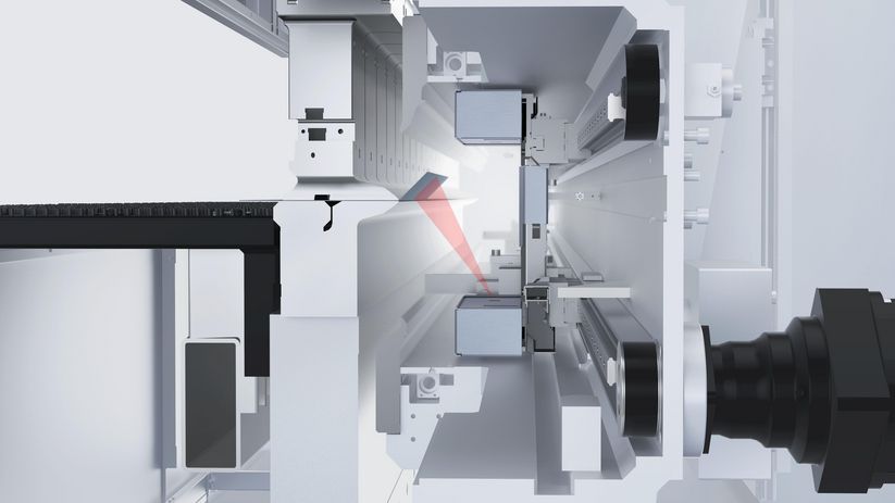

Precision counts.
Because the patented angle sensor ACB laser automatically corrects every bend, ensuring high part quality in the long term.

ACB laser
The ACB Laser ensures maximum precision and repeatability during bending without any reworking. The optical system detects the exact angle without contact and corrects it in real time. This reduces sources of error and rejects, no matter how complex the component is. Decision-makers benefit from consistently high part quality and lower costs, while operators can rely on an automated, reliable process.

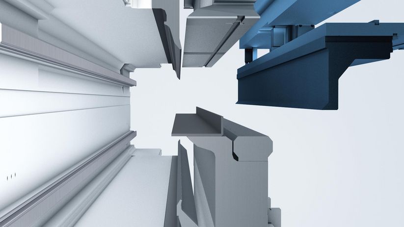

Bending tools
More bending freedom: Benefit from our comprehensive range of bending tools or have special tools created to your requirements. This means that even special customer requirements can be implemented flexibly and economically.
