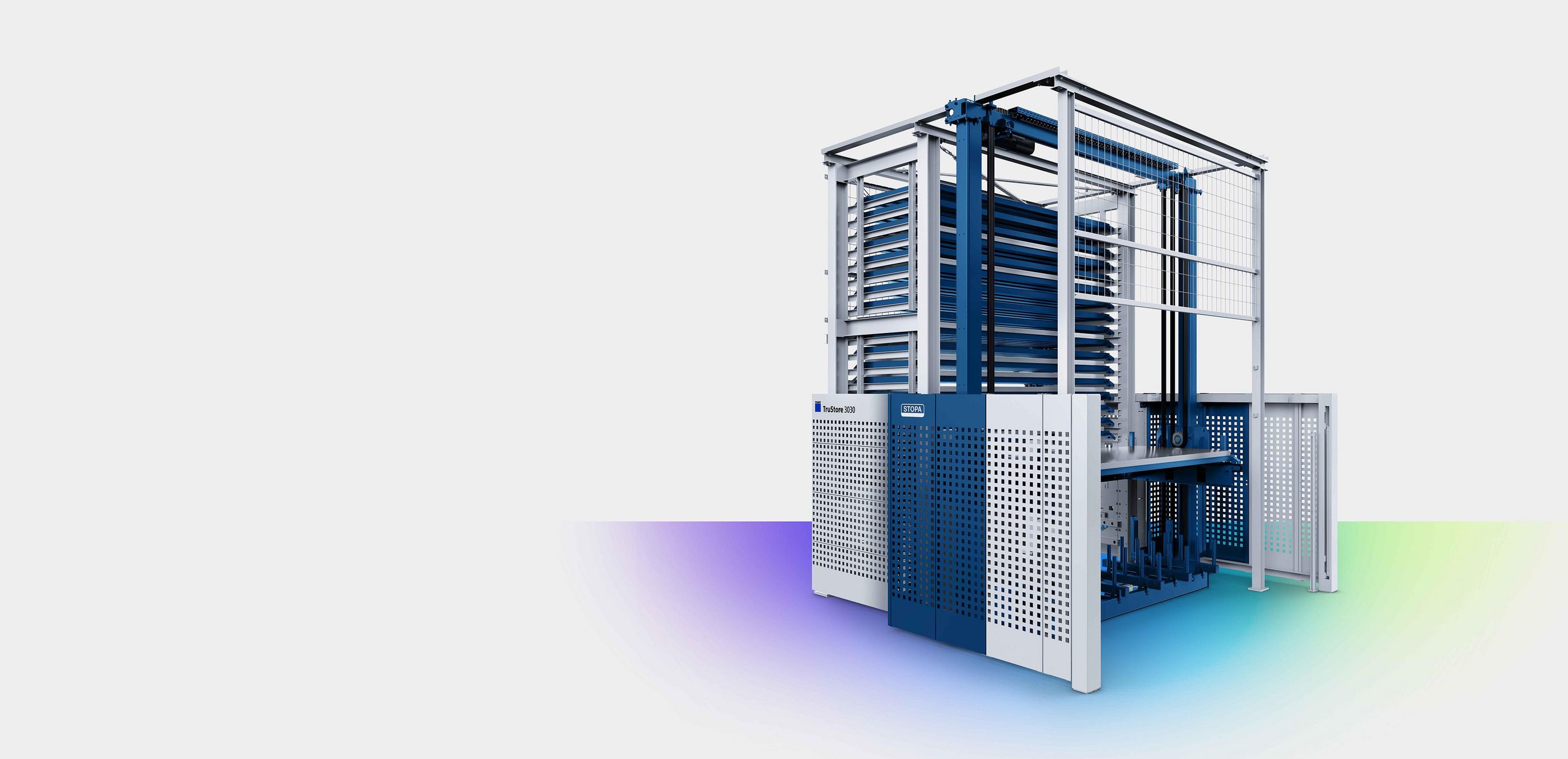

TruStore Series 3000
Small storage system with maximum flexibility
Grows with your requirements
The TruStore Series 3000 tower storage system reduces the space required, and can be expanded into a fully automatic system right up to a cutting and bending cell with several machines. You can select the height of your storage system from 13 possible levels, and the storage compartments can be adjusted to 90, 170, or 260/275 mm. The storage system can be easily connected to your TRUMPF 2D laser cutting systems, punch machines, punch laser machines, and bending machines.

With additional equipment options, you can increase the capacity of the TruStore Series 3000.
Selection of variants for loading and unloading
Choose between large format (3000 x 1500 mm) with 3000 kg loading weight per compartment or maxi format (4000 x 2000 mm) with 5000 kg loading weight per compartment.
Adjustable storage compartment heights
Store material on pallet levels in three storage heights: 90, 170 or 260/275 mm. Loading and unloading heights can be configured separately - to suit your production and the connected automation systems.
Single tower with variable height
With this storage tower with storage lift, you can choose from 13-16 height levels between 3.3 and 8.4 m.  The tower stores up to 36 large format or 24 maximum format pallets.
