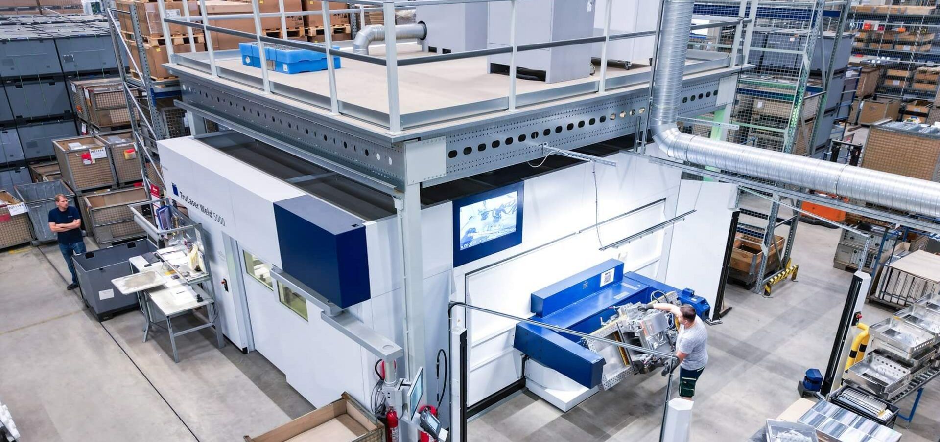

But there is still some way to go before CooolCase can really start welding inverter housings on a large scale. The housing that the customer wants may look unspectacular, but it has a lot to offer in terms of welding technology. CooolCase therefore enlists TRUMPF as a partner to find the optimum parameters and welding strategies. The experts opt for the TruLaser Weld 5000 laser welding system from TRUMPF and start the development phase on the actual customer product.

 Mit der schnellen Taktzeit des Rotationswechslers der TruLaser Weld 5000 fertigt CooolCase 100 Gehäuse am Tag.
 With the fast cycle time of the TruLaser Weld 5000's rotary table, CooolCase produces 100 housings a day.

Now CooolCase can start mass production of inverter housings. Thanks to the high productivity of the laser during welding and the fast cycle time of the rotary changer on the TruLaser Weld 5000, they now produce 100 housings a day.  And just at the right time! This is because manufacturers of inverters for solar systems are facing a double onslaught: the energy transition is continuing to ensure a massive expansion of photovoltaic systems and thus a surge in demand. In addition, many inverters that are already used in older, existing systems currently have to be replaced due to age. "Our company is experiencing solid growth thanks to the inverter order," says Melinda Krusemark: "It feels like we have won the lottery."
